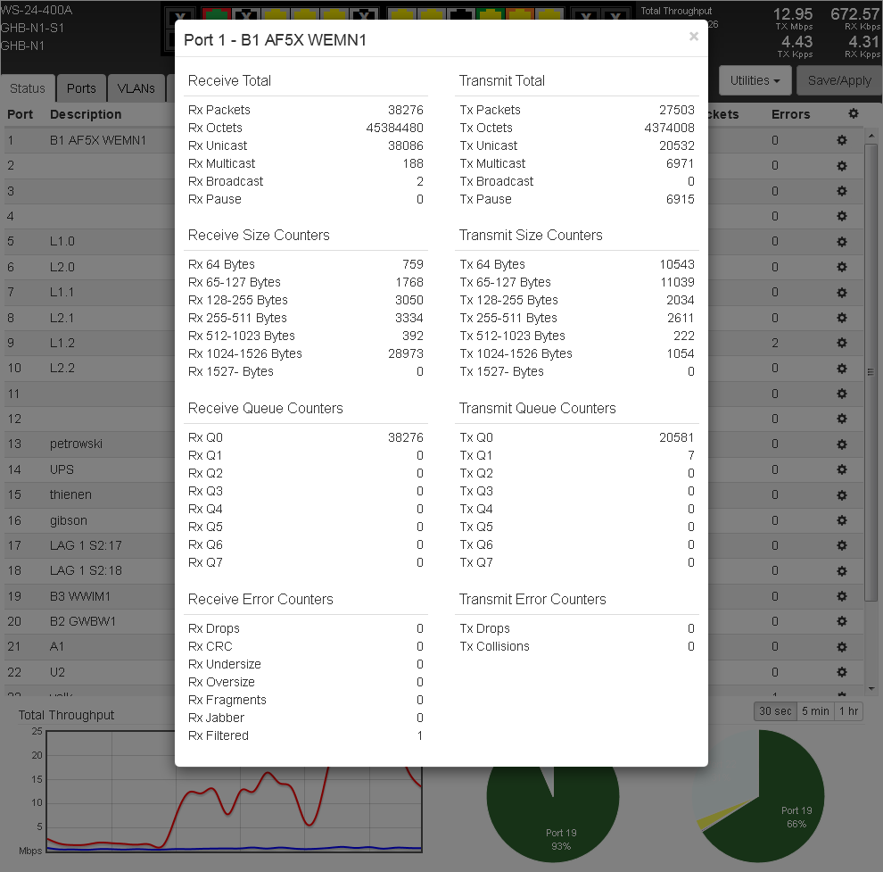

Thinking about a question IntL-Daniel had asked at the UBNT forum on this topic, I did a "clear counters" and created this screenshot after some seconds. Note there are 6915 pause frames sent for 38276 packets received. I've even seen the TX FC counter to go up while the traffic was as low as 1-2 Mbps as seen on the left half of the total throughput graph.
This is the setup for VLAN 100 which connects port 1 and port 5 (nothing else):
AF24 (GbE) <> port 1 (GbE) Netonix port 5 (FE) <> (FE) Router
Traffic then uses other VLANs from other router ports to other 100 meg devices.
Yes, there's a 1000->100 transition from port 1 to port 5. If the logic presented in the best practices video applies, TX pause frames on port 1 must have been caused from buffers filling up towards port 5, because all other devices are in separate VLANs and the router talks to them 100->100 or 100->1000. In fact the FC counters on these other ports in other VLANs are all 0 even without clearing them.
Which leaves me with this question: is it to be expected that 2 to 25 Mbps of traffic on a 1000->100 transition causes the TX FC counter to go up? Even going up while there was only 2 Mbps coming in?
One reason could be that an AF5X, being half-duplex, causes traffic to arrive in bursts because it must buffer downstream packets on the far side while it is transmitting upstream and, once it gets around to sending downstream and having a capacity of 215 Mbps, it sends whatever has been buffered into the switch rather quickly.
Still, I wouldn't have expected 2 Mbps of traffic, even it was made bursty by the half-duplex nature of an AF5X, to cause any device on the switch to generate pause frames. And in fact they didn't, except the switch did on port 1 towards the AF5X.

Your excellent word "bursty" explains it all.
Leave it to the Germans to create a new English word!
Even if it is shown on graph as 2 Mbps which is an average over 1 second (on our switch most other devices are 5 second averages) what is important is how fast the "bursty" is. Buffers are filled and emptied in micro-seconds and even smaller increments of time.
Good idea with maybe the HD nature of AF5X play a roll but people have reported the issue with AF24 I believe (although not as much mind you).

The major difference is (probably) that our routers for smaller sites are still having 100 meg FE interfaces. On all these sites I see a ~ 55% FC rate from Netonix to AF5X. This is not the case for all 1000->1000 situations I checked. So yes, it believe it has to do with 1000->100, but I wouldn't have expected it to occur at 2 Mbps - because it would mean that in every graph second, there's a 20 ms peak of at least 100 Mbps (or else no reason to send a pause frame), and no packet for the remaining 980 ms. Seems to prove that there's more burstiness around than we can imagine.

In general this is correct, but in this case the port was set from Disabled to Enabled with speed being Auto on both sides. So they should have auto-negotiated at that point, and they actually did and agreed on 1000F, but w/o flow control. It could be the AF or the switch but it's a minor issue and off-topic.
The more interesting sentence in my comment was this:
"I wouldn't have expected it [FC frames] to occur at 2 Mbps - because it would mean that in every graph second, there's a 20 ms peak of at least 100 Mbps (or else no reason to send a pause frame), and no packet for the remaining 980 ms."
I still can't believe that a 2 Mbps stream - even if it has some peaks that don't show in the graph - would cause FC action. Again, this may be off-topic but at least it's somehow closer to the subject. Consider this: What if the FC TX and RX counters are reversed in the popup? Then the AF5X would send this amount of FC frames to the switch and the AF5X is the bad guy. But if they weren't reversed, there's something wrong on the switch, I'd say, on paths that involve a 1000->100 transition.
