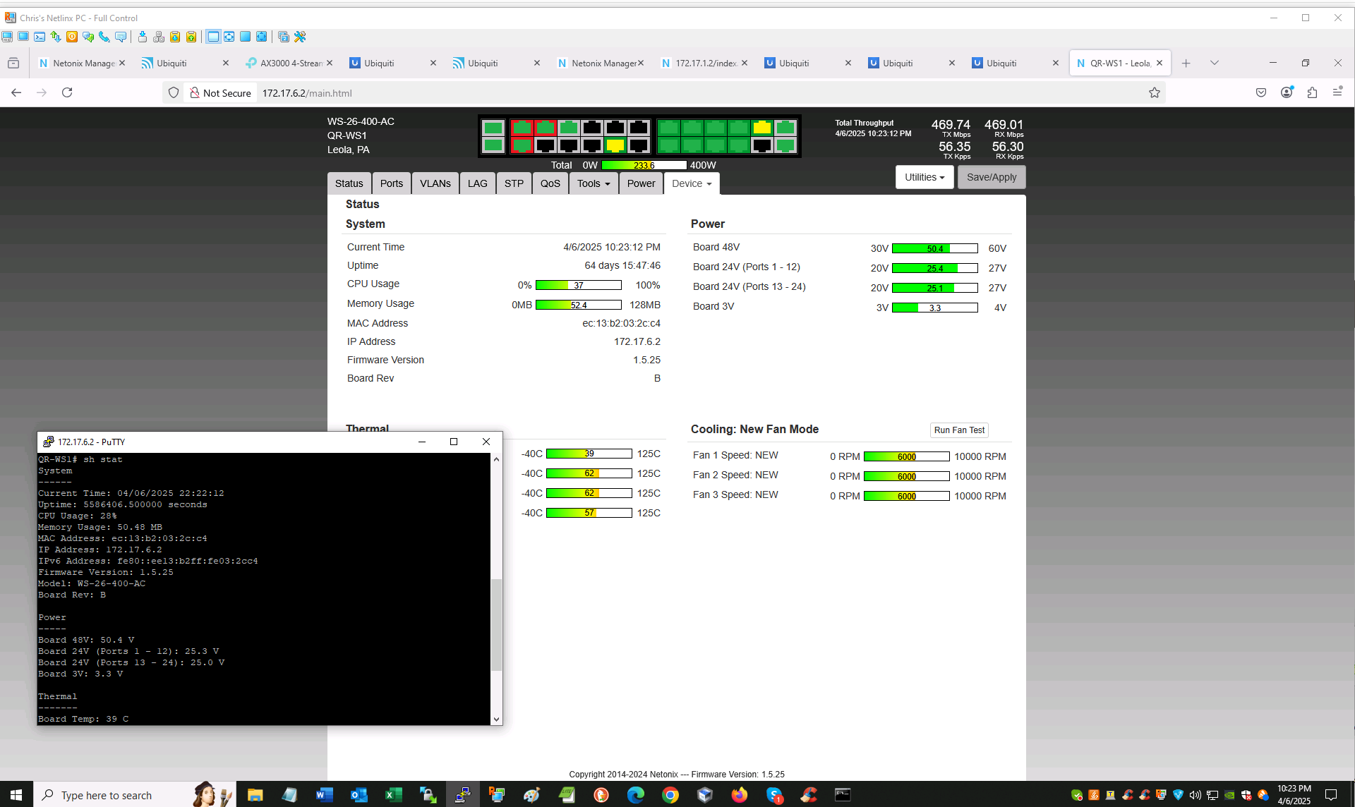

Here is a screen shot of one of my switches.
This is at main tower where main feed comes in so I left this switch upgrade go until last so it went from v1.5.14 or v1.5.16 to v1.5.25
I just logged into it via UI - ALL GOOD
I also logged into it via SSH - ALL GOOD
I tried to login to UI and SSH via password "admin" and both failed.
As you can see they have been up 64+ days.

Upgraded to 1.5.25. Some of the switches do not have the reconfirm password option in the GUI.
I can successfully SSH into the device and enter configure.
When trying to set the credentials by typing credentials - enter. It spits back an invalid command. I have tried all the variations of credentials that I can think of and even tried the ? to make sure everything was spelled correctly. Is there a fix for this?
I also tried a few other commands to see if "credentials" was the only having issues, but most of the other ones are outputting the same invalid command. Any help would be appreciated.
