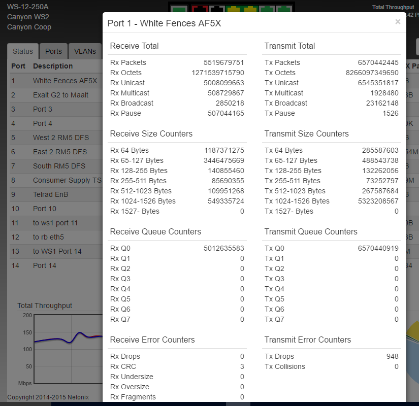

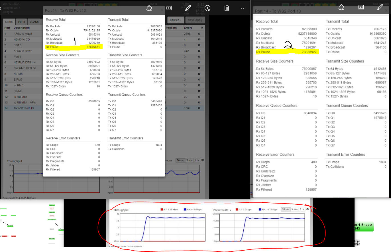

Tonight, in a different part of the network we had another switch "lock up". What I learned is that this IS pause frames coming from the AF5X. And those frames were being broadcast out every port that had tagged VLAN's. Let me explain the site setup.
The tower has two WS12's running 1.3.9 and a Mikrotik CCR router. The primary back hauls are setup as mid-span's, untagged ports, these are unaffected by the pause frame storm. (so I'm calling it) Traffic was happily moving between those untagged ports to the router, no problem.
The AP subnets, mini pop back hauls and customer traffic are all vlan's originating from the router via VLAN's.
The two switches are cascaded together as well as each one connected directly to the router. Switch #2 was the one that locked up (no management from any port) tonight. Switch #1 was taking 8Mb/15K PPS from switch two but was unaffected by the pause storm, at least from a management perspective.
Via an EoIP tunnel I attempted to bridge myself into various ports on the router (a common thing we do) to put myself on the same layer 2 network as the switches (as if I was plugged in to the switch with a laptop, just remote) and no matter what I did I COULD NOT get switch #2 to respond to management traffic. It wasn't until I made it to the side and unplugged the AF5X feeding a pop everything started working normally and was responsive to management traffic and started passing customer traffic.
Here are some things I noticed.
1) The switches being cascaded together is only for management and backup vlan's that can be configured should the router fail. The two ports that link them together only share UNtagged management traffic, no other tagged vlan's are on the port of either switch. - So Why was the switch passing pause frames from an interface the AF5X was connected to, untagged vlan 10 and a bunch of tagged vlan's (customer traffic) to untagged vlan 1 (management)? They do not share an commonality.
2) Why did the interface from SW#2 not show ANY pause frame traffic on the port that connected directly to the router despite that port having ALL the tagged vlans for the AF5X and customer traffic??
In the images I'm including you can see from SW1 the stream of traffic coming from SW2 which was RX pause frames. On the left is the first shot I took and on the right another shot from a few minutes later showing the RX pause frames has gone WAY up.
The second image is from SW2 after I unplugged the AF5X and regained management of it locally. You can see the HUGE amount of RX pause frames on that port as well.
I've read a good number of the threads on pause frames but I don't understand exactly why they would be sent out ports that don't share common VLAN's or why the port towards the router didn't see them (flow control was off on that port, maybe that's why?). Likewise, why would pretty much every other port on the switch (as far as I can tell) have the pause storm traffic being sent out them? Why did it lock up SW2 until the traffic was gone but not SW1? Flow control was on SW1. Why did it not affect the mid-span back hauls? It seemed like if it was going to spill traffic out vlan 1 which wasn't shared either tagged or untagged with the AF5X that the traffic should have been on the mid-spans. Seems maybe the switch is handling the traffic inconsistently?
I also noticed that once I plugged my laptop in, the light on the switch was blinking fast even though my laptop was still booting up. I have to assume that the pause frames were hitting it, BUT when I looked at windows task manager and expected to see 8Mb of traffic hitting it, there was zero traffic. I can only assume that's because windows was taking in the traffic and not reporting it, maybe?
Lastly, why is this just showing up all of a sudden? Or does it just seem that way? This segment of the network has been up for months with the AF5X. It seems to me that a certain rate of traffic is triggering the pause flood. The leg that locked up is routed but only for management. The customer traffic is tagged vlan's between the main tower and the mini pop until I reconfigure the mini pop router. This mini pop also feeds one other smaller mini pop.
SO AGAIN we see the problem come up when there are multiple switches sharing layer 2 domains. Thinking further, the second down stream mini pop isn't even a netonix switch, it's a mikrotik router board that's acting like a switch and it's back haul is a NanoStation Loco M5 link. It seems that it's TRANSIT traffic across the switches that triggers it and it doesn't seem to have anything to do with the fact thatdown stream devices are not AF5X or netonix.
