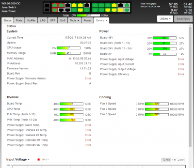

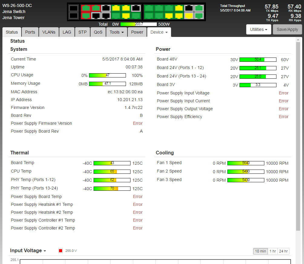

On the WS-26 the upgrade went well, but it appears that the switch rebooted after the upgrade (taking down all connected radios). And now it can't seem to find the power supply. I attached the log, and a screenshot of the status page. CPU usage appears lower now, however it is still higher than a similarly configured WS-12.

Re: v1.4.7rcX Bug Reports and Comments
The power cycle of the WS-26-500-DC on the upgrade is a bug in the power supply bootloader we found after the first PRE-RELEASE (15 units) of the WS-26-500-DC model. We have since fixed this bug in all WS-26-500-DC being shipped now.
Sadly we can not upgrade the bootloader except here in the shop as it requires special equipment to flash the onboard chip but once it loads the "new" power supply APP it should be OK and the power cycle will only happen again if the APP is upgraded in the future but this happen very rarely.
You will probably have to power cycle the switch to correct this issue and as I said a firmware upgrade in the future should only trigger a power cycle IF the APP is upgraded which is rare but it should not cause the symptom you are seeing now with the telemetry failure between the switch and the power supply.
Please try:
1) Simply tell switch to reboot in firmware
2) If above did not correct the issue then power cycle it.
Please try:
