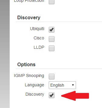

So if you Disable Discovery (the one in the picture below) and then kill the process and or reboot the unit the CPU stay normal?
After CPU is normal from Disabling Discovery shown above can you then enable UDP/CDP/LLDP and the CPU stays normal?
mayheart
Posts: 192
Joined: Thu Jan 15, 2015 1:42 pm
Location: Canada
Has thanked: 48 times
Been thanked: 60 times
Re: v1.4.0rcX Bug reports and comments
Wed May 04, 2016 11:57 am
Correct.
I can re-enable all the options but Discovery without the CPU spiking.
Soon as Discovery is re-enabled regardless of the other options, the cpu will goto 100%.
