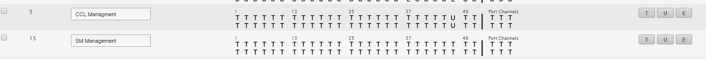

Any possibility of seeing a tag all / untag all option per VLAN, similar to the edgeswitches? Tagging vlans across a 26 port switch takes a little while.
Re: v1.4.7rcX Bug Reports and Comments
Dawizman wrote:Any possibility of seeing a tag all / untag all option per VLAN, similar to the edgeswitches? Tagging vlans across a 26 port switch takes a little while.
I am not sure I follow your request, please be more detailed.
We have a Allowed VLAN List if you click the box at the top of the port column?

I think he mean be able to replicate to all port for a VLAN in 1 click like TAG every ports for VLAN 25 or UNTAG every ports for VLAN 32.

mike99 wrote:I think he mean be able to replicate to all port for a VLAN in 1 click like TAG every ports for VLAN 25 or UNTAG every ports for VLAN 32.
Exactly what I was getting after.
We have a couple vlans that we tag across every port. A one click feature to do this would be great, similar to the edgeswitch, as seen in the screen shot.
