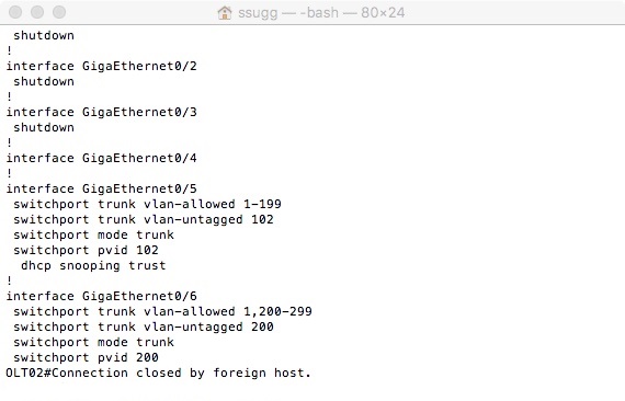

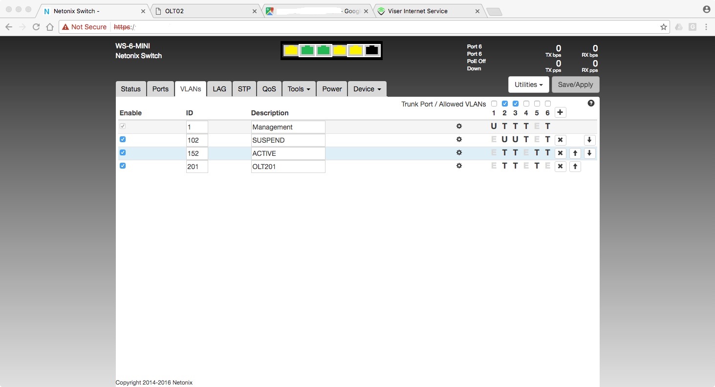

You've still got a bug in VLAN operation on the latest software.
I have port 2 and 3 set up identically on the 6-port switch. On my OLT, port 5 sends VLANs 102 and 152. Port 6 sends port 201. When 5 connects to 2, only VLANs 102 and 152 work. OLT port 6 is connected to Netonix port 3. VLAN201 does not work in this scenario. When I swap the cables for the ports (2 to 3 and 3 to 2), only VLAN 201 works.
All I am doing is a simple cable swap at the Netonix.
I've tried this same test with ports 2 and 6 on the Netonix with the same result.
No changes were made in the OLT or the upstream router. The only thing that was done was reverse the cables at the mini-6.
Re: v1.4.7rcX Bug Reports and Comments
Why do you have Ports 2 and 3 set to pass all VLAN IDs with "Port Trunk/Allowed VLANs"?
Also are you giving it time for the MAC tables to clear and update?
I am pretty sure this is NOT a big as this would be a MAJOR VLAN bug causing all sorts of people problems including me.
You do understand that every switch port has a difference MAC address and is another Layer 2 hop in the chain.
