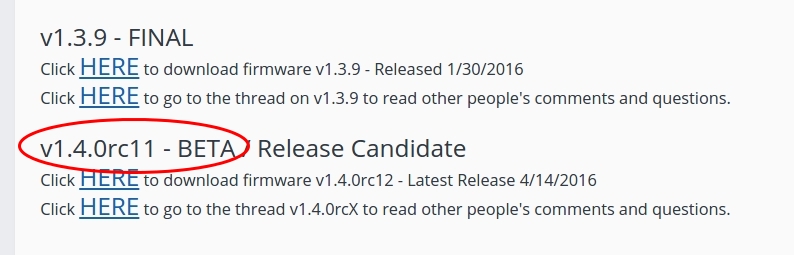

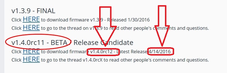

Did I miss the memo as to where you hid rc12?
Re: v1.4.0rcX Bug reports and comments
OUCH - Sorry for the missed character - FIXED
The other things were correct and the link downloads rc12
Hidden in the fine print. I have old eyes.
