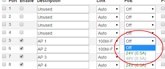

After upgrading one of my switches (WS-12-250A) to 1.3.1 I can no longer power any 48V devices. The ports that were set to 48V are now set to off and the 48 V poe option is grayed out on each port.

Petelarsen, the user above me and I are talking about the same switch
Here are the logs:

The 7AM referenced in the log from 8/20 was the time I upgraded the switch. Ports 5 and 6 are connected to M5 Ti's, which cannot get 48v.
Image below is what the drop menu looks like, with the greyed out 48v
