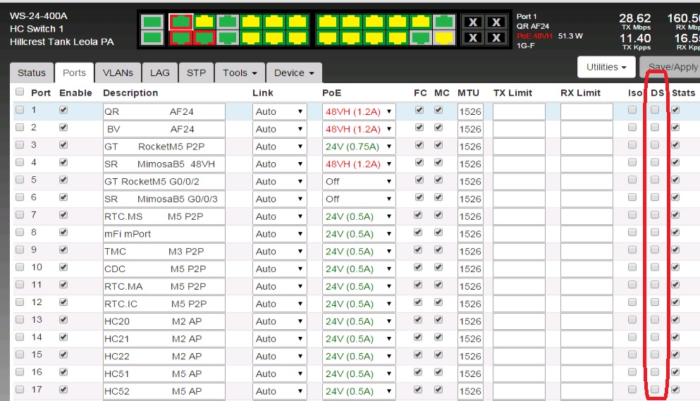

I am still not getting an IP when set to DHCP client and now I have devices that are not getting IP addresses either.
One device I have is easy to test and none critical, so if I use the Ubiquiti Radio's POE adapter and place a spare Netgear switch between the Wisp Switch port ( The port that is connected to the backhaul radio for the switch ) and the POE port marked LAN then plug my device in to that Netgear switch, I get an IP from the DHCP server, if I put everything back on the wisp switch the device will not get an IP address.
There seems to be a problem with DHCP and the switch.
Re: Data dropping under load, no DHCP
By chance you do not have the DS check boxes checked under the ports Tab for any of the ports do you? *see below*
