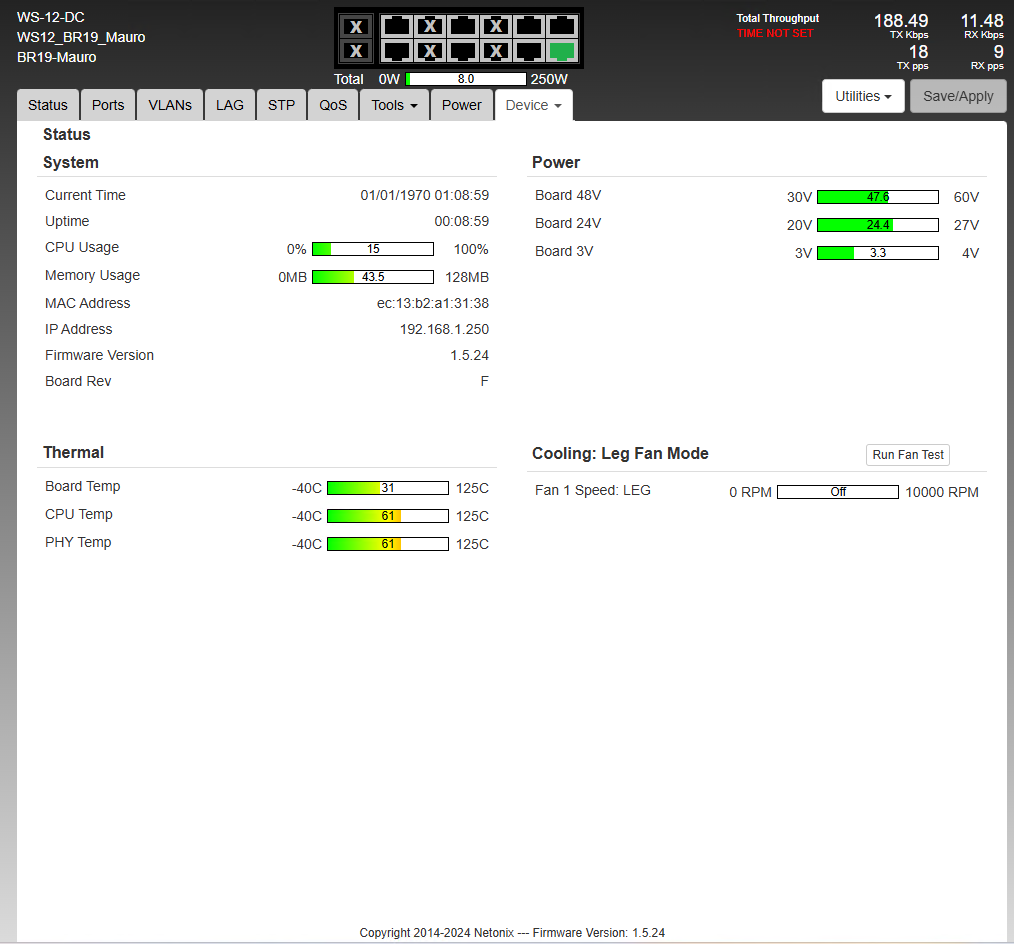

Re: Power Supply i2c communication error
Thu Jan 23, 2025 11:56 am
Hi,
looks good to me now:
Thank you very much
