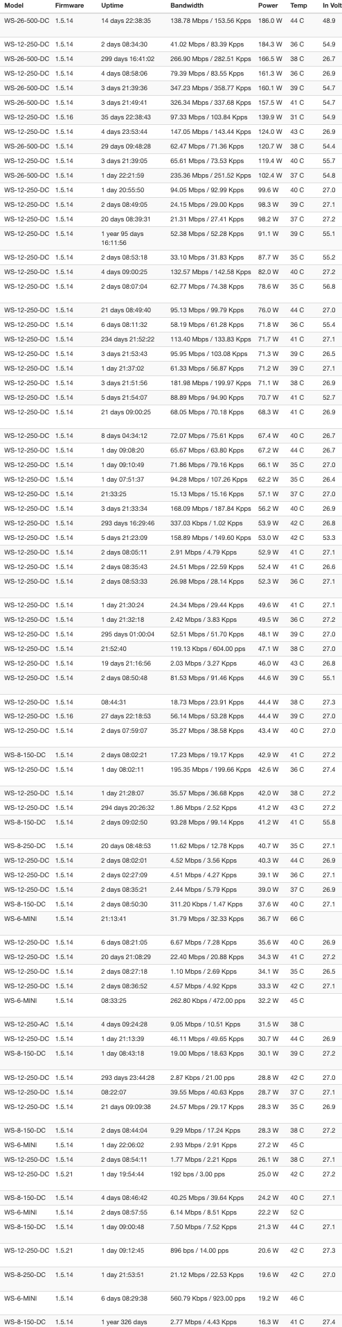

We have over 200 Netonix switches on this network alone (I consult and manage other operations as well).
Partial list from Netonix-Manager of units we recently downgraded (about 3 more pages of that - won't fit in a screen).
