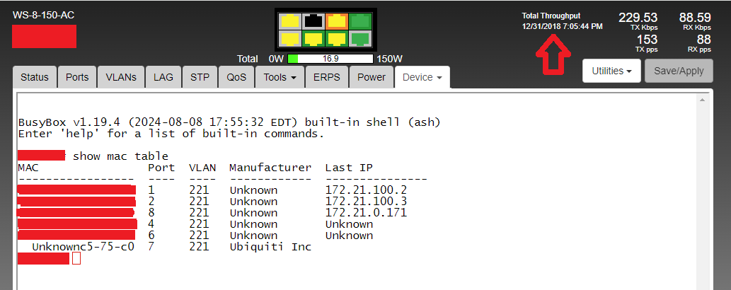

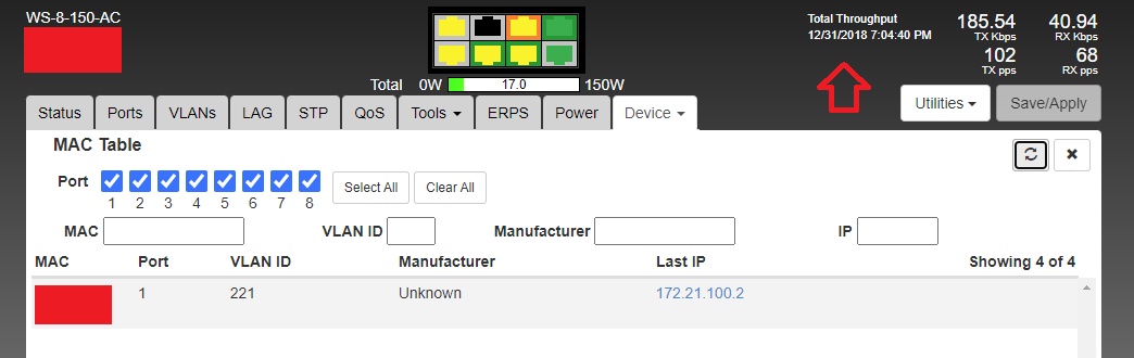

sakita wrote:Loaded 1.5.17rc2 on a WS-8-150-AC Board Rev F in my test rig. This is the switch connected to my laptop and 7 other devices (which includes devices that communicate with each other providing a little traffic).
The MAC Table page in the web UI wasn't showing all of the MAC addresses that were shown when issuing a "show mac table" command in the web UI Device Console. At one point there were no addresses on the MAC Table page but were on the Console. Flushing and refreshing didn't change anything... and then the list on the MAC Table page magically started displaying again but still not matching the full list shown by the Console.
I rolled it back to 1.5.17rc1 and the MAC Table page and Console now show the same list consistently.

For example, with 8 devices plugged into the switch the console list would show all 8 but the web UI would have less than 8 devices in it.
Note that the time is not set as I don't have NTP available in my lab setup. I just re-updated the switch to 1.5.17rc2 and grabbed these two screenshots with 7 items plugged in.
Port 7 on the console is interesting as it added "unknown" as part of the mac address.
