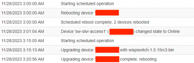

Today we experienced another SFP related issue. Our uplink is via an SFP port (14)
We had a WS-12-250-DC that was on firmware version 1.5.14 (Board revision F). Using the Netonix Manager, we scheduled a reboot and then a firmware upgrade to 1.5.15rc3. Switch rebooted fine, then proceeded to upgrade fine. After post-upgrade reboot, the switch disappeared.
Here are the Netonix Manager logs:
Netonix Manager Logs
We still had physical link on our router, but there was no RX traffic coming from the switch. One of our technicians visited site and moved uplink from SFP port to one of the copper ports. Management was restored immediately. Looking at the logs after reboot, port 14 never came online.
Switch logs:

We then moved the uplink back from the copper port to the SFP port to see if it would spark port up. No dice. No entries in the logs for the port move. Upon a physical switch reboot, the switch was now accessible via the SFP port again.
Re: v1.5.15rc3 Bug Reports and Comments
Tue Nov 28, 2023 9:43 pm
Leave switch on, pull the SFP module and then re-insert it, I bet it comes on line.
