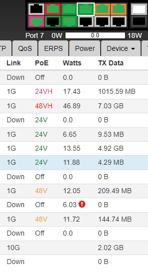

- Also seeing total wattage reported as low. ~15W total on both the AC switches. ~30W total on the DC switch. Per port the top bar shows 0.0.
- When turning a port off with cable still plugged into it, the port will perpetually show error "POE is disabled, power should be 0. I don't know if this continues after a reboot. Doesn't seem to happen every time, but most of the time, I'd say.
Screenshot showing both my points on this particular switch (WS3-14-600-DC):
