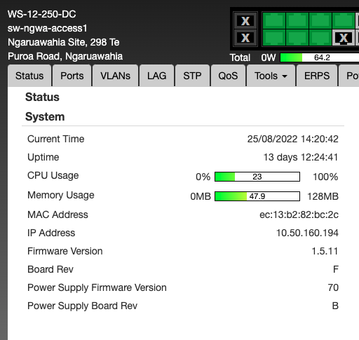

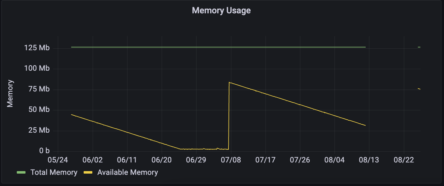

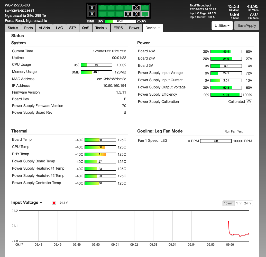

And on that note, I come bearing news I posted earlier somewhere between 1.5.11 - 1.5.14 posts about a potential memory leak I have encountered.
On advice from someone to look at disabling SNMP, I can confirm that when I disabled SNMP on the switch that demonstrated a potential memory leak, that available memory has remained high.
Below is an image of the trend showing a constant decline of available memory
Memory loss
Here is the switch memory after a fresh reboot and SNMP disabled. You can see uptime of switch is 1 minute
Switch reboot with SNMP disabled
And here we are almost 14 days later where the available memory is still the same as the day it was rebooted
Memory usage after 14 days
I have had SNMP enabled on the switch for less than 24 hours, and the available memory is again on the decline. I can currently observe this exact trend on about 5 different firmware versions dating all the way back to 1.4.9, all the way up to 1.5.11. And this issue isn't present on just one switch type. It is observed on the WS-8-150-DC, WS-12-250-DC, WS-26-500-DC and the WS-26-400-IDC. It's also observed on both older board revisions, as well as fresh out of the box revisions.
I'm happy to supply any diagnostic data if it will help get to the bottom of this.
