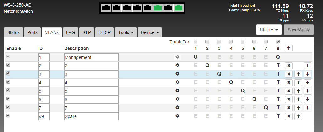

Q-In-Q.... Chris, do you have some examples of how this may be configured via the GUI?
EDIT: I got it working:
QinQ
Thanks,
Jim
