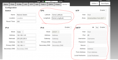

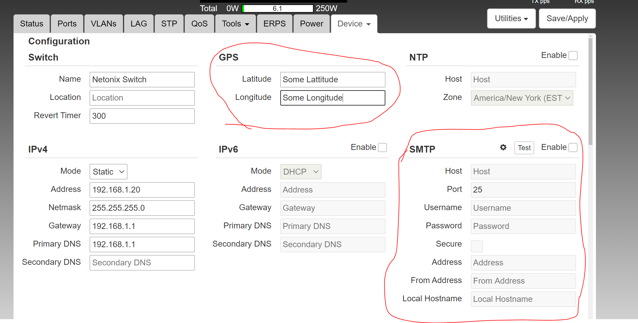

quadra,
The problem is that SNMP server is the wrong configuration option.
SNMP = Simple Network Management Protocol.
What you want to setup is the SMTP option.
I will post a screenshot for you to see.

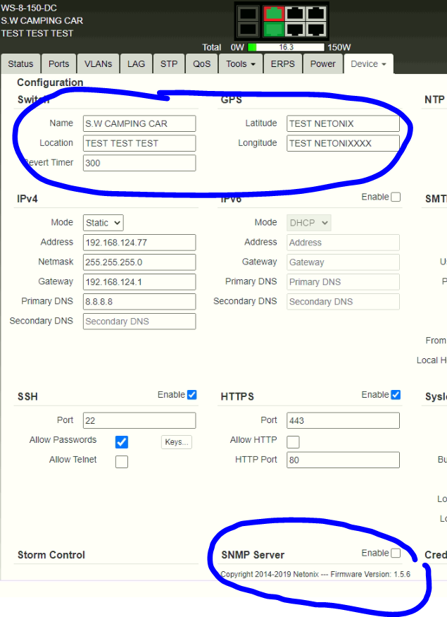

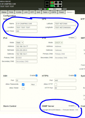

Hello
non j'ai bien remplis le champ SMTP
ce que j'ai entouré en bas c'était pas SNMP , c'était pour montrer que j'avais bien fais la mise a jour 1.5.6
sinon SMTP est bien remplis

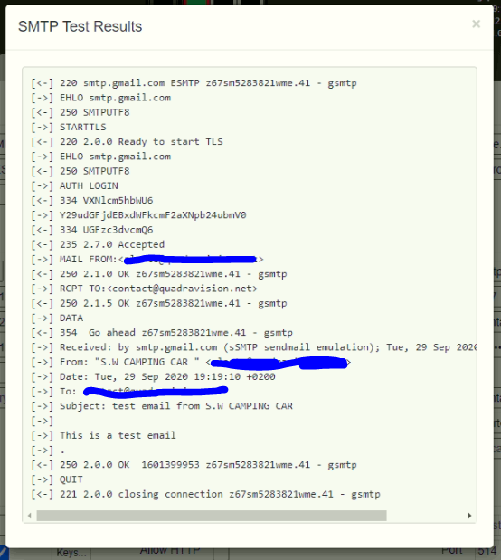

There are no error's in the software that I can find. Also it behaves precisely as I would expect it to and I cannot replicate this issue.
If you want help, I need more information to figure out why it is failing for you.
Please provide a screenshot of what happens when you click "test" under SMTP.
Also I need to see the log entries that show what happens when a watchdog event occurs.
