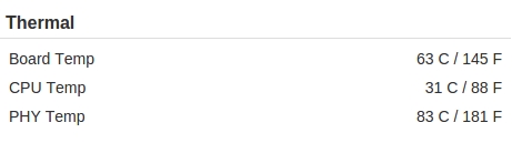

CPU temp looks bogus on the MINI

lligetfa wrote:CPU temp looks bogus on the MINI
I believe if you re-read the emails we discussed the temperature sensors on the "PROTOYPE" we gave you were wrong.
From: Les Ligetfalvy [mailto:les]
Sent: Thursday, April 02, 2015 8:57 AM
To: Chris Sisler
Cc: David Olive
Subject: Re: 1.1.6 and MINI
OK, good :/ to hear the numbers are bogus and have been since resolved. I will avoid making mention of it in public.
I put the cover on the box and the temps jumped up 10 degrees.
Board Temp 77 C / 171 F
CPU Temp 116 C / 241 F
PHY Temp 95 C / 203 F
On Wed, Apr 1, 2015 at 11:00 PM, Chris Sisler <chris@netonix.com> wrote:
Les, the CPU temp on that board is WRONG, there was an issue with that circuit, fixed in production units.
