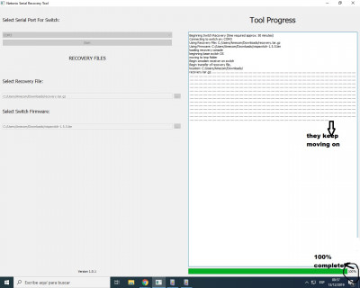

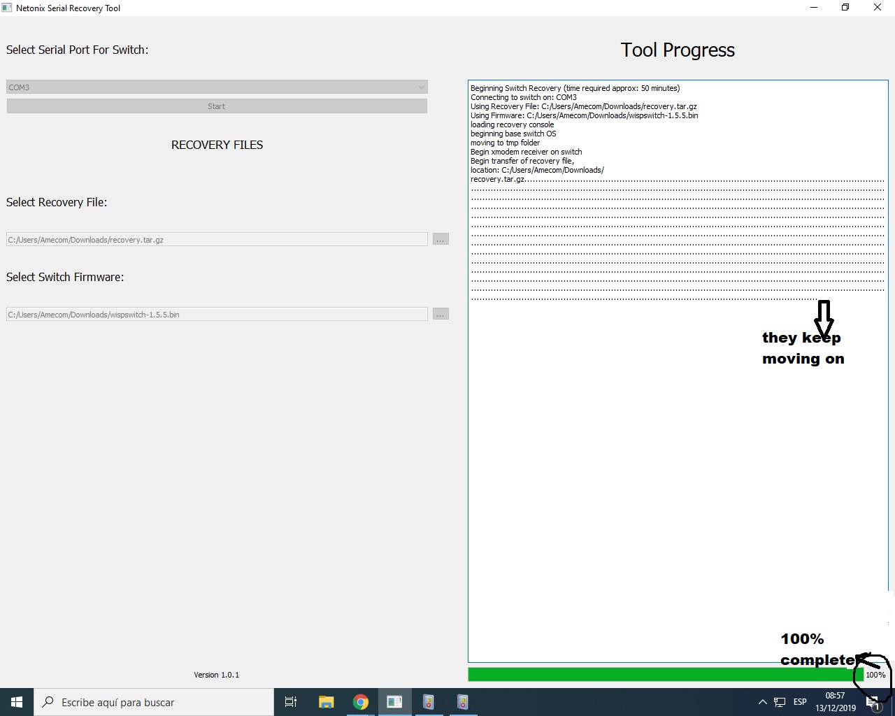

1) Im using a usb-serial converter and then a female adapter to plug in the switch, that should work? Or I need a null (female) serial cable without any adapters?
2) When the progress is over? The 100% is complete but the little points are moving. I have to wait something else?
Thanks in advance.

FSod
Posts: 6
Joined: Thu Apr 06, 2017 12:35 pm
Re: RECOVERY TOOL VIA SERIAL FOR SWITCHES
Fri Dec 13, 2019 8:10 am
Hi Stephen!
Thanks for your answers. Im sending the screenshot.
Thanks!
