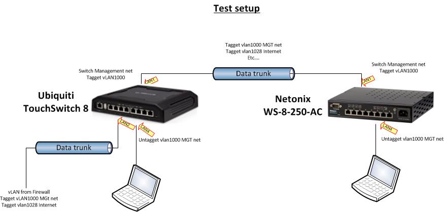

This is the test setup only ToughSwitch 8 and Netonix WS-8-250-AC is needed, just reboot the switch and see the resoult with ping to netonix switch from the 2 computeres.
the computer on Netonix switch get answers from netonix trunked mgt ip interface, the computer on ToughSwitch 8 fails on reboot's of Netonix switch
Test:
1). Reboot Netonix from webinterface menu, wait... when it's online again wait 4-5 min Reboot again...
2). After 3 reboots do a unplug of power cable wait 30 sec, plug-in power cable.
3). if not unstable begin from 1). again
After max: 4 reboots the switch got unstabel in our test.
/Carsten
