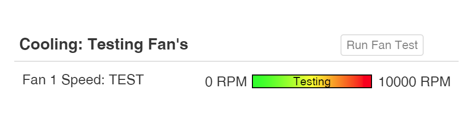

It's getting harder to find bugs now that the firmware is getting so good! Here's a screenshot from the Device Status page where there shouldn't be an apostrophe in "Fan's". Do I get a prize for the most trivial bug ever?

Thank you for the feedback on the bug it is very helpful. Added to the list.
