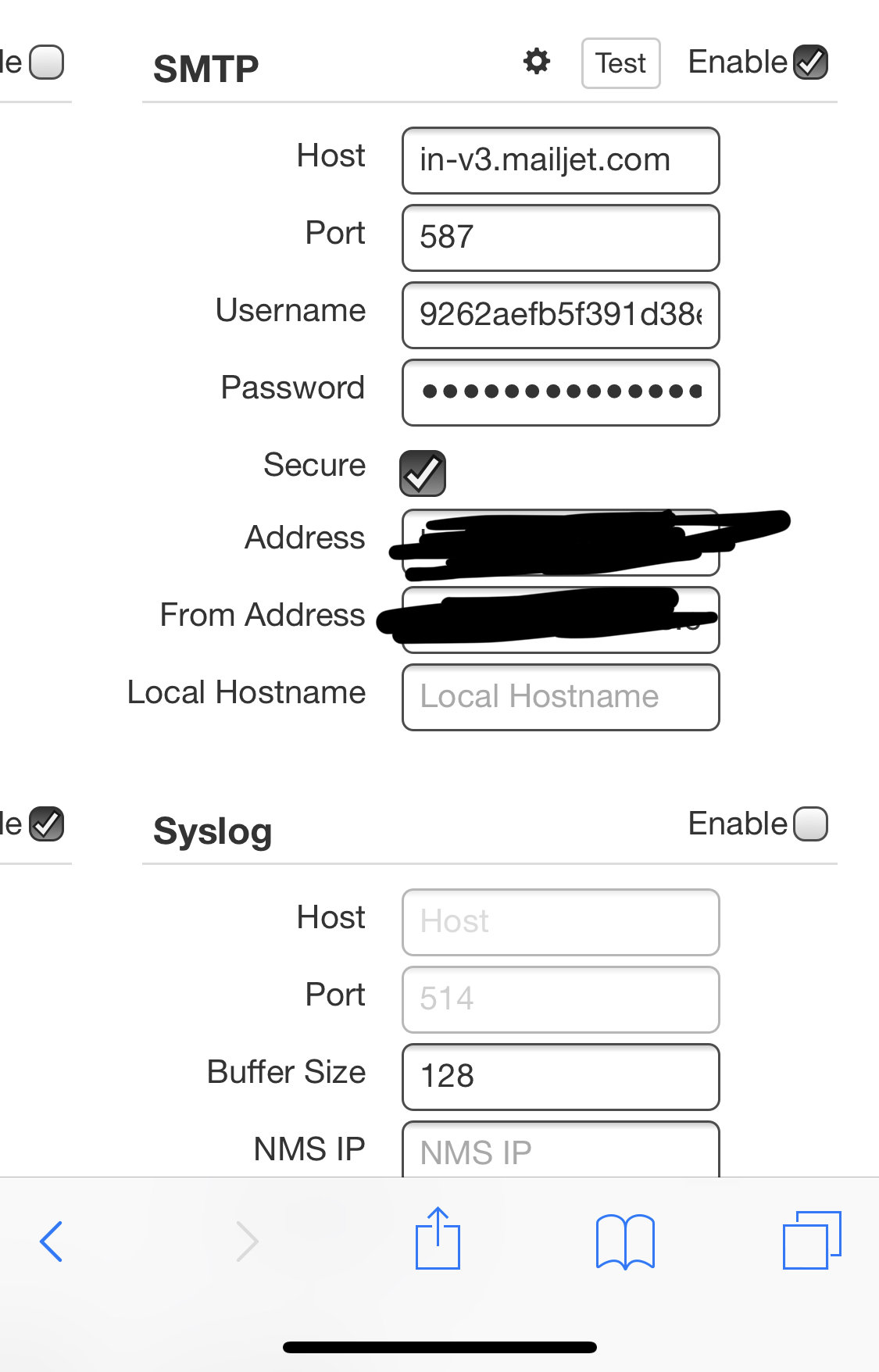

Here’s a quick screenshot of my mail setup and I have the low voltage reboot issue too..

Looks like you are using a third party service to handle smtp. And after looking briefly at the doc's mailjet does offer postfix as an optional message transfer agent. If you have the option, see if changing to a different MTA change's whether or not the switch crashes. Exim maybe.
