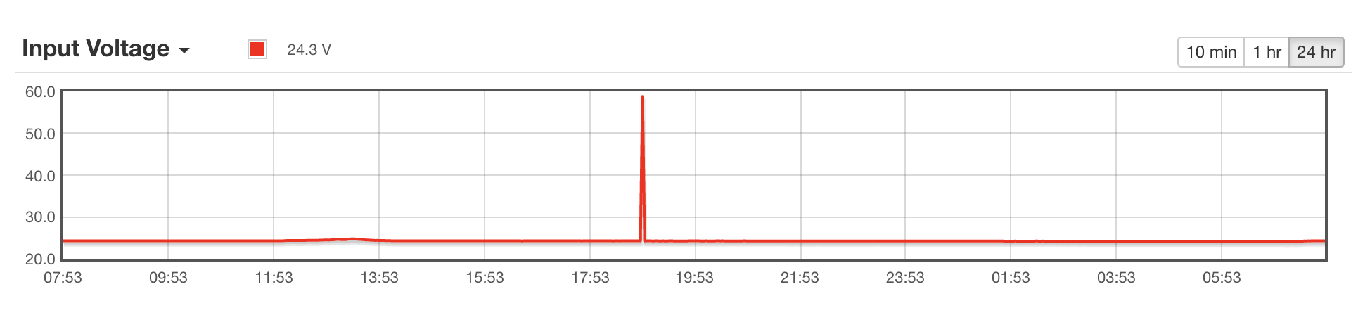

Well, the switch went 10 days without a spike, but we got one at about 6 PM last night. See image below.
We do have a wind turbine on the site, but it is electrically disconnected from the system with a relay. But it could be creating some electrical noise I suppose.

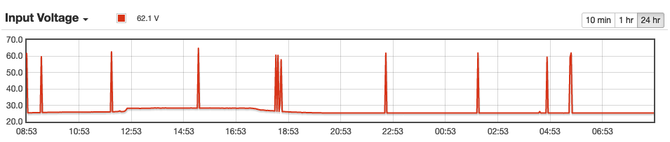

Re: Voltage Spikes Unexplained
We also get these random spikes - which I agree are likely some sort of interference rather than actual voltage spikes. They have happened to us even when no charger at all was connected to the batteries powering the Netonix DC switches. We see them on nearly all of the switches where we have 60GHz radios connected to the Netonix switches - Ubiquiti, IgniteNet and MikroTik. I have also tested putting an extra switch between the 60GHz radio (a Netonix Mini), and the interference still passes through to the DC switch. As another test, we've had a second DC Netonix switch alongside the switch connected to the 60GHz radios and connected to the same battery. When the spikes appear on the Netonix connected to the 60GHz radios, they don't appear on the second DC Netonix that's there only monitoring the voltage. We also don't think it's related to how we power the radios, because we've experimented with having direct DC to the radios rather than POE coming from the Netonix switches with no change. Take away the 60GHz radios and the spikes disappear.
We also have spikes showing on our 250-DC connected to LifePO4, solar powered (including spikes in the middle of the night). We do have a 60GHz from Ubiquiti on port 2 (48v, 11 watts). Never had this problem before adding the 60, but we added it quite a while ago.

Dave - Employee
- Posts: 730
- Been thanked: 158 times
Leighton
Correct me if I am wrong, but you said one Netonix switch hooked up to DC supply, but not hooked up to radio via network cable, just monitoring battery voltage, shows no spikes, but the other Netonix device, hooked up to same battery, but connected via network cable to the 60G radios, does show the spikes.....did I understand you correctly?
Thanks.
