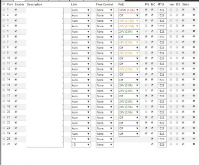

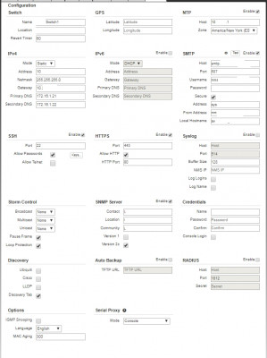

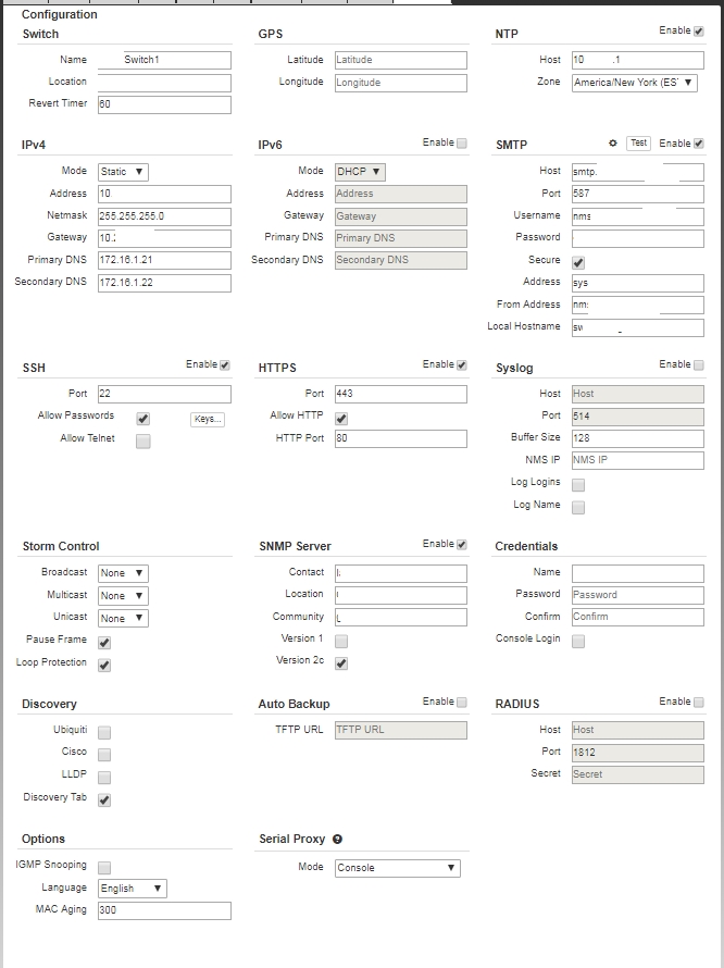

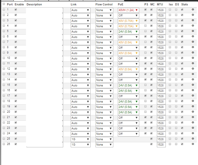

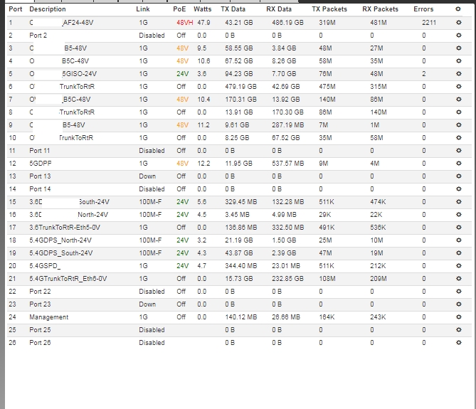

Please see attached. If you need the un-redacted versions pm me a email address to send them to.
Cheers.

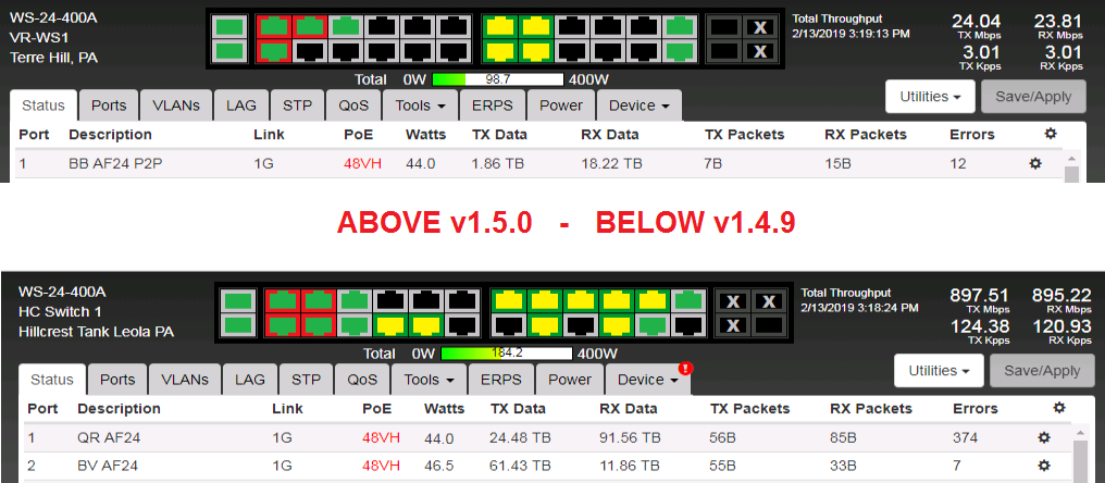

Hmmm,
Seeing a lot of packet error's on port 1.
Try disabling Pause Frames and see if that stops.
If that doesn't do it, then also try disabling Loop Protection to see if there is any improvement.

Re: monitor: restarting vtss_appl
Ya those errors have always been happening. I have 6 x AF24's on 6 different Netonix and they all do that. I've never been able to figure out why and I've read on the UBNT forums that it's not uncommon.
That is not the port I am pinging the Switch through from the attached router. That is not the cause of the packet loss which started when I upgraded this switch from 1.4.7 to 1.5.0 to 1.5.1 to 1.5.RCx
I'll try disabling those and see if it makes a difference. Thanks.

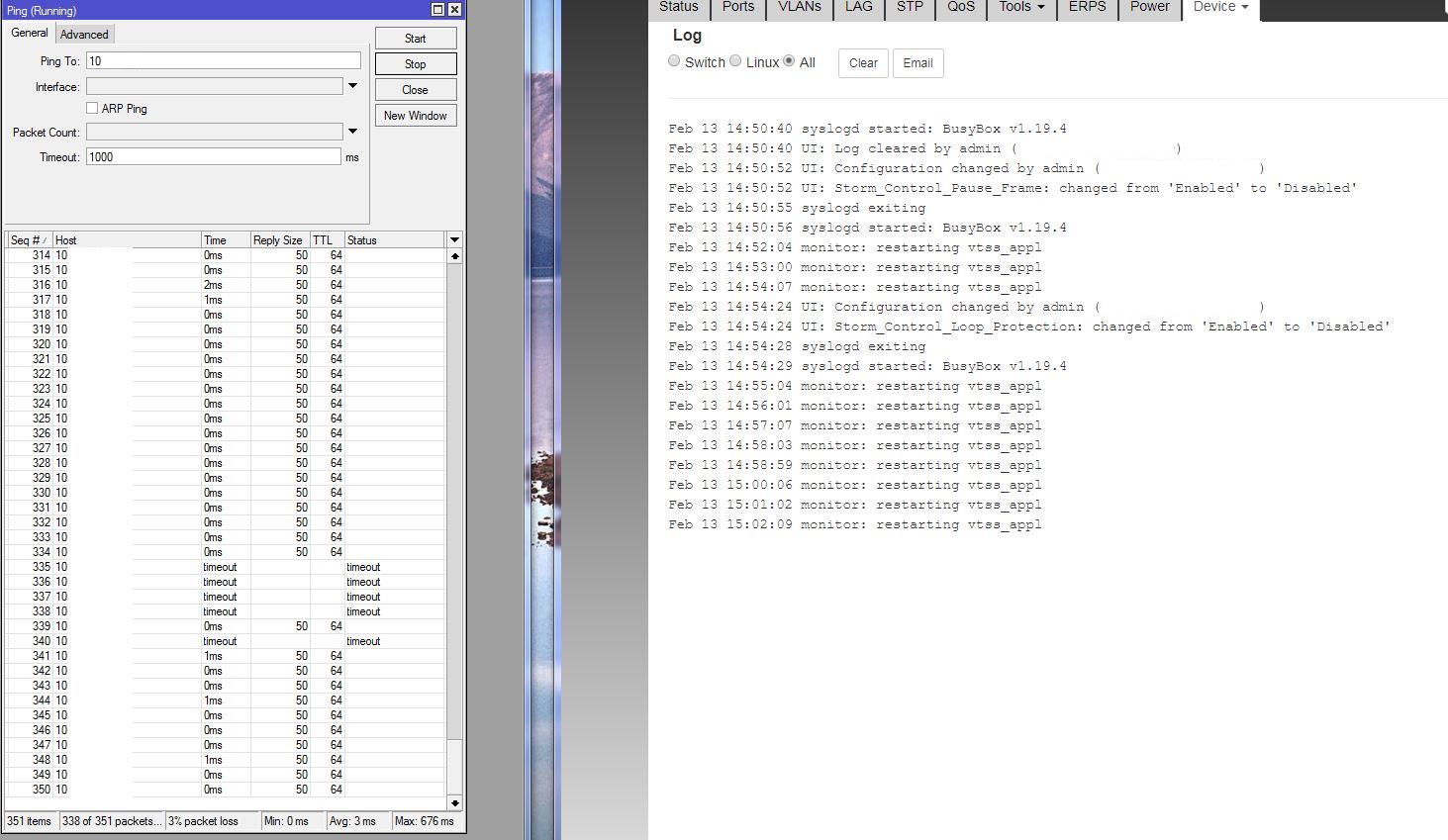

No luck. Might even be a little worse with them turned off.
Still errors on the AF24 port too - but that really isn't my primary concern. I'd like to have a plan to deal with this packet loss problem...
Is it possible to go back to 1.4.7 ? Or any other options ?
There are still a few options.
What's happening is vtss_appl is crashing for some reason. We need to know why.
If possible on your network setup, try disabling STP and see if that helps.
