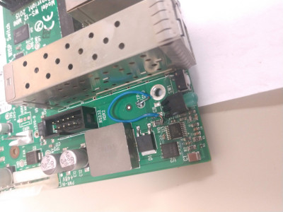

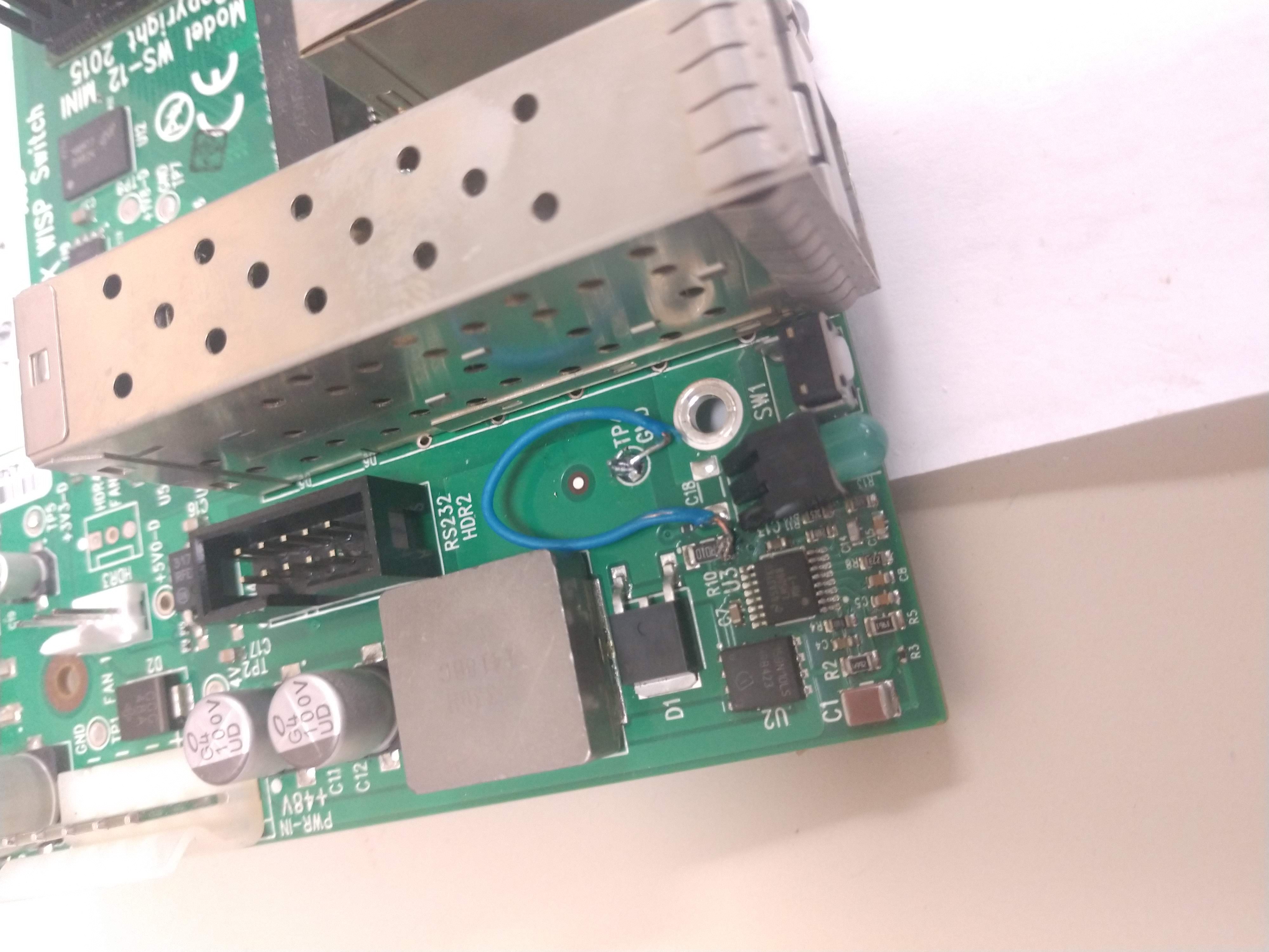

So I did the mod on one of my WS-12-250 switches. My soldering skills are not the best but I think I got it right. How would I know that it is working properly?
Re: Increase the on board 24V power supply capacity
If you have some test equipment such as load generators you could test being careful not to load more than .75A per port, but as long as your soldering is OK should be fine.
On your next unit make sure wire is at least 24 AWG and make it a little shorter if possible.

sbyrd - Experienced Member
I can remove the wire if you think it is a problem. Also I knew you wanted 24AWG so I saw on the boxes of Ethernet cable I have it says 24AWG so I assumed each wire was 24 AWG. Is this not the case?
Also should I not trust my work on this one can I still get this RMA'd and modded by you guys for the ~$50 charge?
sbyrd wrote:I can remove the wire if you think it is a problem. Also I knew you wanted 24AWG so I saw on the boxes of Ethernet cable I have it says 24AWG so I assumed each wire was 24 AWG. Is this not the case?
No, it looks like it will work provided your solder connections are good.
All I said was make sure it is 24 AWG or heavier.
I also said next time you do it try and make sure the wire is a bit shorter if possible.
And finally I said while your at it you could have done the GROUND MOD maybe?
