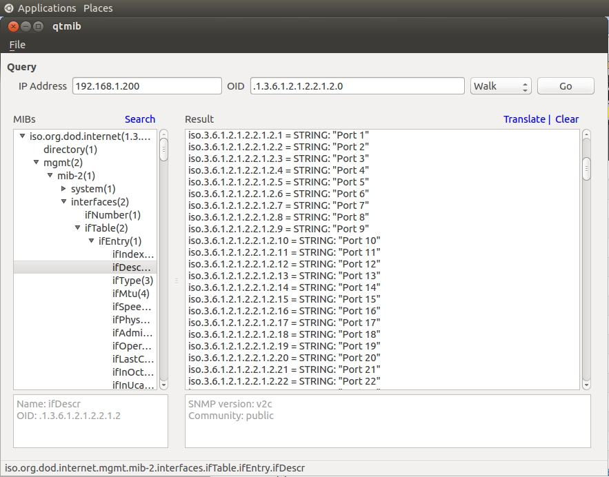

What OID are you looking to for the port description? I've only been able to pull the default description, not what I entered.

I just asked the programmer (Eric) about this description

Added port descriptions for SNMP to the To Do list.

FIXED
Eric changed/fixed SNMP not reporting port description entered in UI in the latest firmware release v1.0.10rc8 now available for download.
Please test it and report back what you think!

rc8 fixed both issues... mini_snmpd starts on reboot and descriptions now show on a walk.
