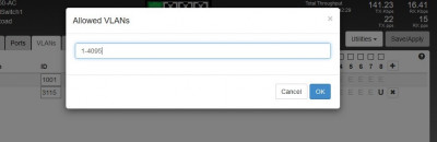

sirhc wrote:Can you posts a picture of the POP UP menu where you configure the Trunk Port / Allowed VLANs.
Here it is:
