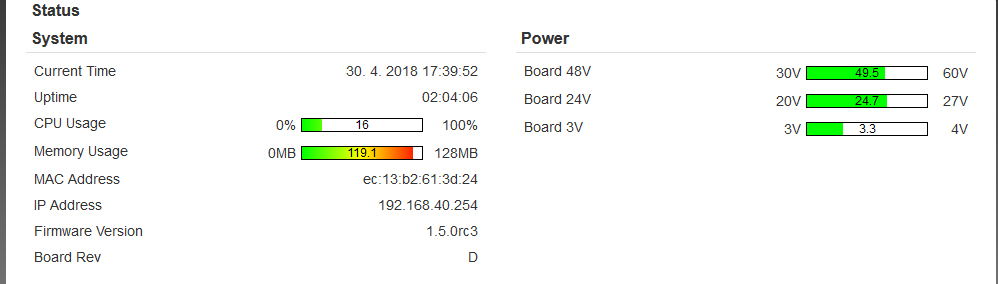

I have just tried to enable SNMP on my WS-12-250-AC on 1.5.0rc3 and memory consuptipon stated to raise every second... at the state below I didi quickly reboot task from WEB UI to avoid crash...

IntL-Daniel wrote:I have just tried to enable SNMP on my WS-12-250-AC on 1.5.0rc3 and memory consuptipon stated to raise every second... at the state below I didi quickly reboot task from WEB UI to avoid crash...
A little more information would help.
After you restarted the task did the problem come back forcing you to disable SNMP?
How often are you polling the switch with SNMP as you do not want to poll the switch every second.
Please provide more details.

Hello IntL-Daniel,
I tried to recreate the issue in my lab. I have PRTG Network Monitor setup to query a WS-12-250-AC every 60 seconds and activated SNMP both v1 and v2. I noticed that if I had both SNMP versions v1 and v2c active at the same time it would cause a brief spike in CPU Usage but it quickly settled back to about 20%. I allowed the system to run in these different state's for at least an hour a piece and never saw the memory spike more than 44.1MB
Could you provide us with some more details about your setup?

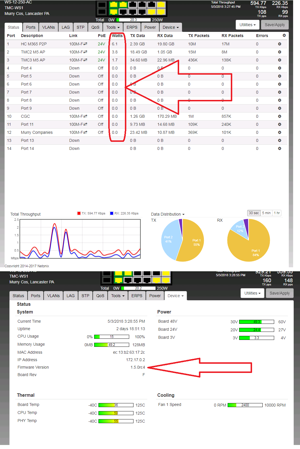

In the main "Status" tab, did the Watts field get removed in 1.5.0rcX? I just upgraded a WS-8-150-AC and a WS-12-250-AC and the Watts field which was next to PoE is gone.
Re: v1.5.0rc3 and newer Bug Reports and Comments.
wirelessblue wrote:In the main "Status" tab, did the Watts field get removed in 1.5.0rcX? I just upgraded a WS-8-150-AC and a WS-12-250-AC and the Watts field which was next to PoE is gone.
WS-8-150-AC does not have per port watts - NEVER DID
http://forum.netonix.com/viewtopic.php? ... tch#p13339
http://forum.netonix.com/viewtopic.php? ... tch#p13550
I am looking at my WS-12-250-AC and watts column is there?

Thanks. I missed that detail. I must not have checked the WS-12-250-AC unit properly because it's right there now that I look at it. Thank you.
