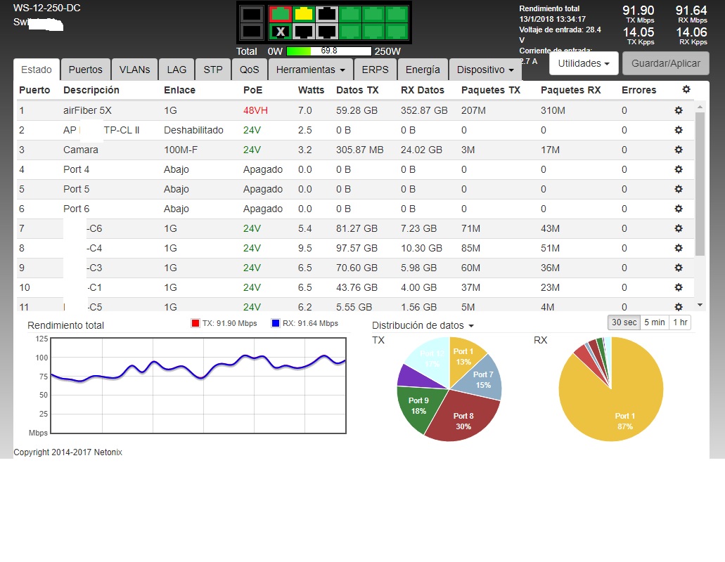

sirhc wrote:
jg0007 wrote:I found a bug After the update I can not turn on a port ie enable it from OFF to 24 in the registered one but the switch does not power the port
You have red arrows pointing to port 2 and port 3 in your original post picture.
Port 2 has an X on it because it is disabled on the Ports TAB
if I have only the LAN port 2 disabled the problem is that it does not activate the POE does not send to energisarlo that is the fault
Meanwhile I will return to version 1.4.8
I need to activate the power to those port with version 1.4.9 does not allow me to do it

jg0007 wrote:if I have only the LAN port 2 disabled the problem is that it does not activate the POE does not send to energisarlo that is the fault
WHAT ?
Explain that again please

Since I went back to version 1.4.8 it allowed me to activate the POE everything works fine without problems
Note version 1.4.9 has this error does not allow to activate the power to the POEs that are deactivated nor does it comply with the programming of power off and on programmed in the power TAB
These comments are to improve version 1.4.9
