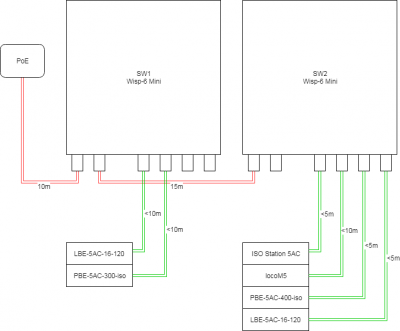

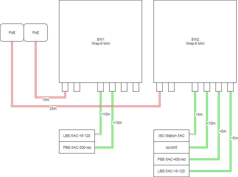

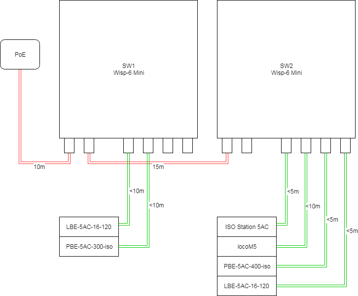

Could the defective CAP cause less frequent reboots? We have a site with two WS switches powering 6 antennae, lets call them WS1, and WS2.
Originally we had a PoE brick power WS1 which powered WS2 via port2, and WS2 powered the incoming antenna (terrible design decisions were made).
We kept losing contact with the site, switches were rebooting. So we replaced the cable for WS1. Died again.
So we ran a new cable for WS2 back to our power souce and a second PoE brick.
Now at least we're only suffering 5-minute outages, but WS2 is still rebooting.
ec:13:b2:91:a5:72
Anything you can recommend? I've a brand new switch I'm programming a new switch to replace this so I'll have it running in a lab environment in a few hours.

Re: Switch rebooting periodically......
Fri Jul 06, 2018 1:55 pm
Possibly? I can not tell you the cause unless we test it.
I am guessing these are WS-6-MINI units as you never specify?
I am also guessing that you are daisy chaining these units (WS-6-MINI) meaning POE brick powering WS1 which powers WS2?
What model is the POE brick?
How long of cables from POE brick to WS1 then how much cable to WS2?
Are you powering any radios with WS1 and if so how many and what are they?
How many radios are you powering with WS2 and what are they?
You could also simply have a power issue here as well?

Hey Chris,
This was the original setup, where we first noticed there were problems. Cable lengths are conservative estimates - I think we're under 10m supply to SW1, and under 15m on the supply for SW2. PoE is this Ubiquiti 54v.
All antennae are Ubiquiti models, 24v.

When issues continued we switched to this setup with two PoE bricks.
All equipment is behind a UPS (replaced that before we moved to the second setup). I doubt it's mains-power related, just because it hasn't affected the first switch, nor has the first switch complained about power being out of range - not sure about SW2 because the log gets cleared every time it reboots.
Cheers,
