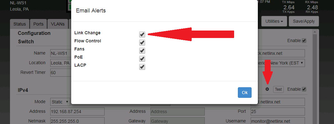

Chris, please READ my posts, i love your product, but your ignoring me and what im typing, the fact I have posted a few times already that I GET EMAILS FOR EVERYTHING EXCEPT 1G to DOWN, DOWN TO 1G. Im not sure how much more clear I can say this?
I get emails from this netonix for:
Watchdog alerts
Voltage alerts
1G to 100 alerts
100 to 10 alerts
10 to 100 alerts
1G to 10 alerts
the list goes on... all alerts seem to work fine... EXCEPT..
I dont seem to get 1G to DOWN, or DOWN to 1G as it happens so fast, I pasted a snippet from the log in a previous post showing the UP/DOWN.

Did you check this?

There are no notifications for link state changes, only unexpected link speed changes. It does say "Link Change" in the notification configuration, I guess that could be worded more accurately.

yep all tickedImage
sirhc wrote:Did you check this?

So if a link was flapping for 2 days (like mine was) your saying it wont send out an email because its not unexpected? can this be coded so that it emails for all link changes and not just unexpected ones, as we didnt notice this was a fault until it went offline completely, the issue was water in the port and it was shorting, radio stayed powered up but water was on a data pair so it was going from 1G to DOWN and back to 1G.
BTW, I counted all my netonixs today and i have 84 with more being added every week, id hope that gives me some weight to get some dev work to make sure that link state changes for everything are emailed.
If it had emailed us for each one we would have got dozens of them and known it was a fault we needed to fix ASAP, most likely within half an hour, and not 2 days.
Eric Stern wrote:There are no notifications for link state changes, only unexpected link speed changes. It does say "Link Change" in the notification configuration, I guess that could be worded more accurately.

Let me also apologize for not looking closely at your log in your post to see it was link up and down instead of link speed changing.
So here is the rub. We can assume it is an unexpected link speed change when it goes from 1G/100M to 100M/10M.
I will ping Eric to see if we can also report link up and down events.

This is really a job for an NMS, especially if you have that many switches.
