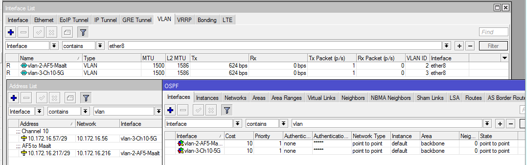

here is the code from the tik on the vlan config.
Code: Select all
/interface vlan
add interface=ether8 l2mtu=1586 name=vlan-2-AF5-Maalt vlan-id=2
add interface=ether8 l2mtu=1586 name=vlan-3-Ch10-5G vlan-id=3
add address=10.172.16.57/29 comment="Channel 10" interface=vlan-3-Ch10-5G \
 network=10.172.16.56
add address=10.172.16.217/29 comment="AF5 to Maalt" interface=\
 vlan-2-AF5-Maalt network=10.172.16.216
Also including a picture of the tik for reference.
tik to ws config.PNG (31.59 KiB) Viewed 15351 times

I haven't had the time to digest everything fully yet, but it looks like you are setting the MTU on the tik side to 1500 and the wispswitch to 1560. Lets try bringing both of those to be the same value. Now, I'm not seeing the interface mtu on the tik side, just the vlan mtu, so I may be in left field, but afaik the mtu (actually ethernet frame size, I hate how those terms get used interchangeably) for dot1q trunks is 1522. Lets make sure the interface on the 'tik side has its mtu set to at least that.

The MTU that matters on the mikrotik is the L2MTU and if you look at the screen shot I sent over it's set for 1586 on both the vlan and the physical interface. I'm pretty familiar with VLAN's in tik and use them all the time and have no issues passing full 1500 byte frames with my setup, so I don't feel like it's an MTU problem. Again, If I plug the tik in to another tik OR a HP Procurve switch, the vlan's function just fine. It even works with the WS as long as it's not on a SFP port.
