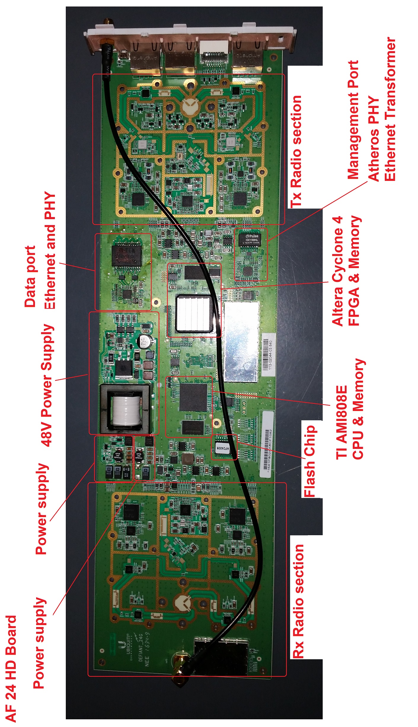

It is impossible that the switch under any circumstances can do any damage to an AF radio as the AF radio is a 48V device that accepts power on all 4 pairs and there is no way the switch can deliver more voltage than 50V +/- as it has no way to STEP UP voltage beyond what the power supply provides the switch board and besides an AF can handle up to 60V before damage can occur.
After you explained the grounding which sounds good I am leaning more towards a ESD charge or possibly a direct strike.
You seem dead set on blaming the switch so not much I can do about that. However we are very familiar with the AF boards as we are soon going to be offering repair service on those units since UBNT will not.
If you want to investigate your AF then open it up and refer to the picture below.
If the board is damaged from ESD then you will most likely see damage in one or both of the Radio sections.
If you have damage to the Data/Main Ethernet Transformer and PHY then you are dealing with ground current.
Damage to the 48V power supply but no damage to the EThernet Transformer and PHY would indicate a SURGE of excessive voltage > 60V.
Damage to one of the other 2 power supplies "if an AF24HD or an AF24 with its Ground lug connected" but no damage to radios sections is most often ground current.
Re: WS-12-250-AC Overvoltage - Killed all radios attached to
In the above picture you will notice the flux around the Transformer and PHY of the main Data Ethernet Port.
This was an AF24HD I lost a few weeks ago on a tower where we are still battling the grounding ever since Sprint left the water tower we co-located on and their crew stole the '" copper ground cables for salvage and cut all the Halo #2 TIN for salvage when they removed their equipment from the water tank over a year ago.
And most recently the township installed a backup generator on site and their electrician messed with the service grounds which we had to fix again after this damage occurred. SO far no more damage but time will tell.
The ground current took out the switch port Transformer and the Ethernet Transformer and PHY in the AF24HD.
This unit is now repaired and will be going back into service which will save me $3,000.00 since this damage was not warranty damage by UBNT.
Total cost of repair about $10 in parts and a couple hours labor so if we were doing this for someone else say $200.00+/- repair fee and they save a $3,000 radio.
