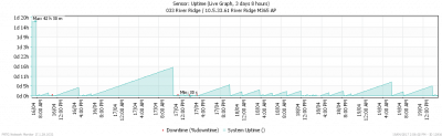

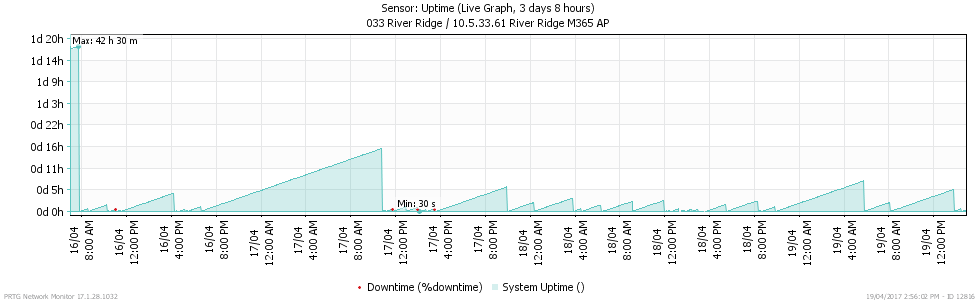

As for when it occurs, it is random. Anywhere from 30s to 42 hours. Here is the uptime chart for one of the AP's from PRTG:

And all 24V radios reboot at the exact same time? ( verifying )
They simply reboot once then 30-40 hours rinse and repeat?

Most of the time they all reboot at the same time, however I see a few occasions where one or two of the radios did not reboot. It's anywhere from 30 seconds to 40 hours, most commonly around 25 minutes or so.
