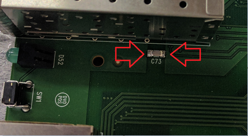

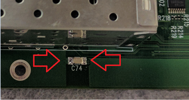

Looking for the WS-24-400 rework instructions before deploying next switches ... Chris, did you post them?

For the 24-400A: First point of modification is to the right of the 2-gang SFP stack on the left hand side of the board with the ports facing you. The component to replace is marked C73.
Note the power LED and reset button for direction if you get lost.
The second point of modification is to the right of the 4-gang SFP stack on the right hand side of the board with the ports facing you. It is near the edge of the board. The component to replace is marked C74.
For the 24-400B, the rework locations are the same, as well.

Thanks a lot! You didn't mention what to do, but from the other rework instructions I guess we should put a short instead of C73 and C74, and these caps may be missing in hardware revisions before F.
