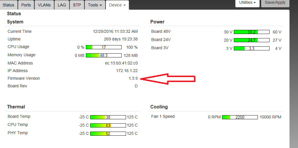

Seth, please upgrade switches to v1.4.7rc4, your firmware is REALLY OLD.
Before you upgrade make sure none of your passwords are longer than 8 characters and no special characters as we had a password bug fixed a long times ago.
I think you are possibly seeing Pause Frame storms from your AFX radios which is a known UBNT bug.
v1.4.7rc4 has protection against this.
Read the release notes and get up to date.
Also upgrade AF radios to latest firmware UBNT claims they fixed their Pause Frame bug.
I have no idea how old your MT firmware is but I know ours is OLD.

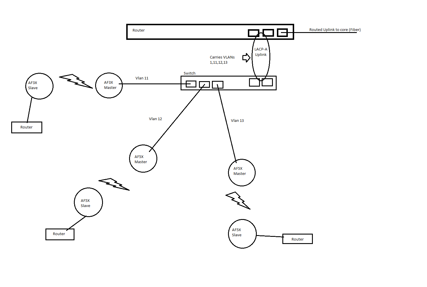

Please make a diagram of your towers, links, routers and such.
I will warn you now that I suck at diagrams, but I will do my best.
Also I am not using the LAG with the wireless links, but with the Uplink from the switch to the router. Very similar to what you do.
viewtopic.php?f=17&t=237#p836
Ports 1 & 2 are aggregated using Static Aggregation to our Cisco 2951 router, remember that Cisco does not support LACP in a lot of routers.

Here is the best I could come up with using the tools I have right now. If it is not sufficient let me know and I will try to do better.

Picture/Diagram is great, thanks.
Now please update and screen captures of Config Tabs in thread above to match what current setup is (if anything has changed).

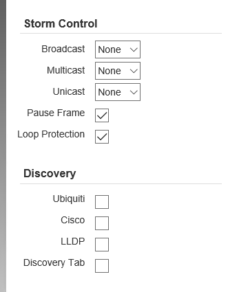

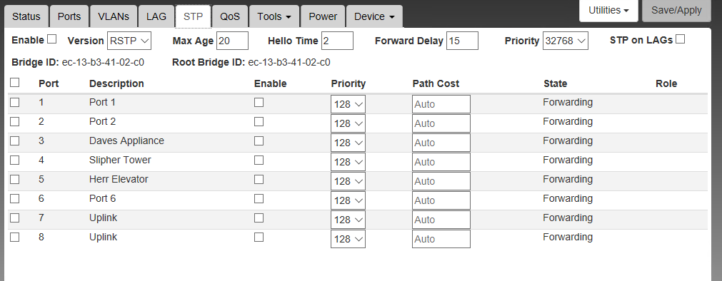

Only config changes on the switch in an attempt to resolve the issue.
STP has been disabled on the switch. This eliminated the LACP going up/down randomly but did not fix the data stall issue.
Turned on Loop/Pause Protection and turned off Discovery
New Device Config 2.PNG (8.96 KiB) Viewed 33844 times
