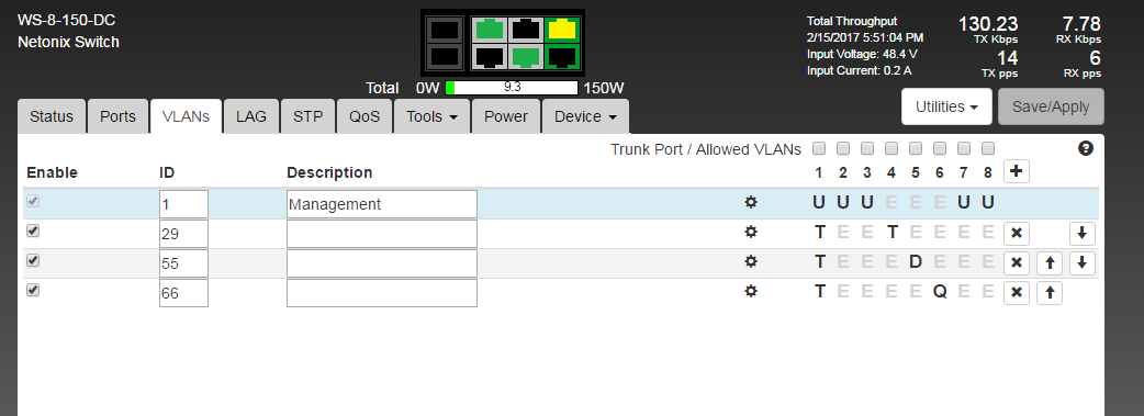

Here is the screenshot again of my config. If I have the QnQ VLAN 3rd in the list I lose communication, 2nd in the list everything works as planned.

QinQ and Double Tagging should be fixed in 1.4.7rc9, which should be available soon.
Additionally, you should now be able to do a setup like this:
In this example port 1 is the upstream connection, either directly to another switch or via a radio or something.
You can access the management interface of the switch using untagged frames on port 1.
Any devices connected to ports 2 or 3 will also send frames upstream untagged.
The device on port 4 must send tagged frames for VLAN 29, and those frames will be sent upstream unchanged.
The device on port 5 must send tagged frames for any VLAN, and those frames will be sent upstream after adding a second VLAN tag (VID 55, TPID 0x8100).
The device on port 6 must send tagged frames for any VLAN, and those frames will be sent upstream after adding a second VLAN tag (VID 66, TPID 0x88a8).
You should be able to add any combination of U,T,D,Q ports all with a T on port 1 and it should work as expected.
