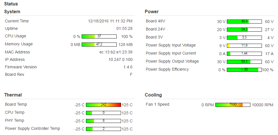

I'm seeing the same thing on one site, except I see high board and cpu Temps. The CPU temp bounced from 0 to 242 and back to what I think is the actual. It's currently -7f at that location.
Both stayed pegged at 242 and I rebooted the switch and the cpu started flapping back and forth.

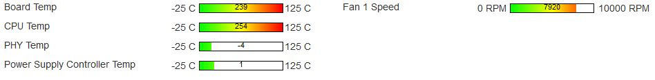

Tue Jan 03, 2017 12:47 pm
Cold temperatures are back and so are the crazy board temperatures. I replaced one WS-8-250-DC that had crazy perceived temperatures with a WS-8-150-DC and here is the screen shot.
