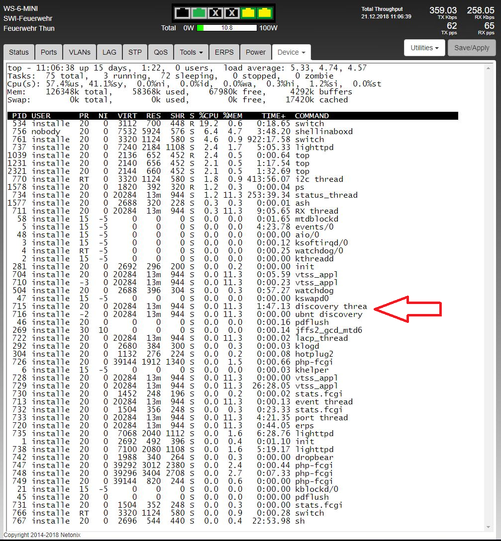

It is very difficult to find out which service loads the processor so much, if the display of the Linuz shell does not show this.
We have a simple configuration and can not switch off more.
Constant 95% to100% CPU Usage

If you reboot the unit does it return to high CPU usage?
Please post up a screen grab of the whole Device/Configuration TAB and any TAB with any changes from default.
Re: Constant 95% to100% CPU Usage
roman.truog@ict-plus.ch wrote:Thank you for your reply. yes, we did not activate all of the listed services.
In your TOP screen grab it shows UBNT Discovery and Discovery TAB services running?
Please confirm UBNT Discovery and Discovery TAB is DISABLED then reboot the unit

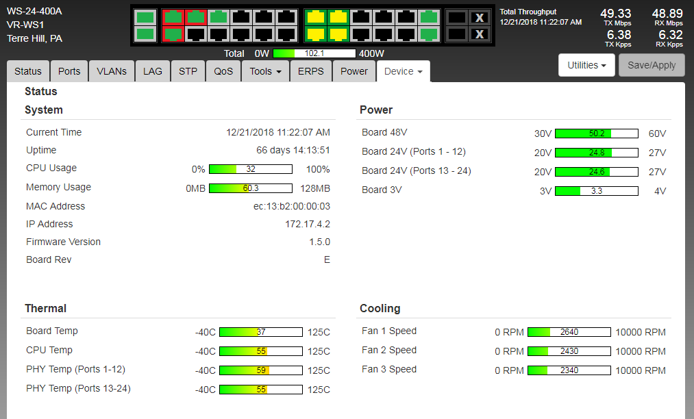

Also when you first login to the switch the CPU will spike near a 100% for a bit then settle down.
The grab below is after I logged in and let CPU settle down, took about 5 or so seconds but when I first logged in it spiked to near 100% for a bit.
