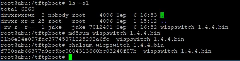

Any chance someone has the MD5 or sha1 sum for this? I Just want to make sure I know I have a good copy of it.
Thanks,
James

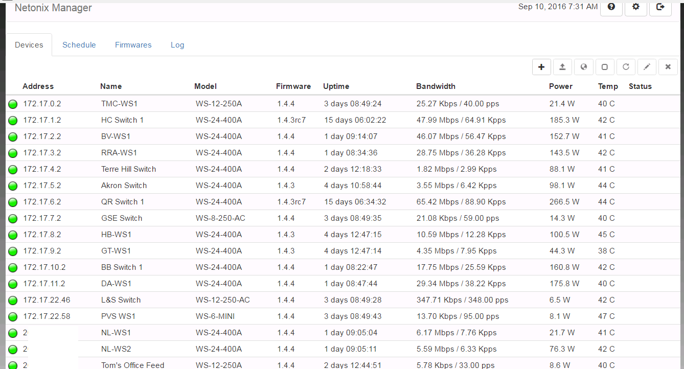

This is what I show, installed and working flawless on my switches
