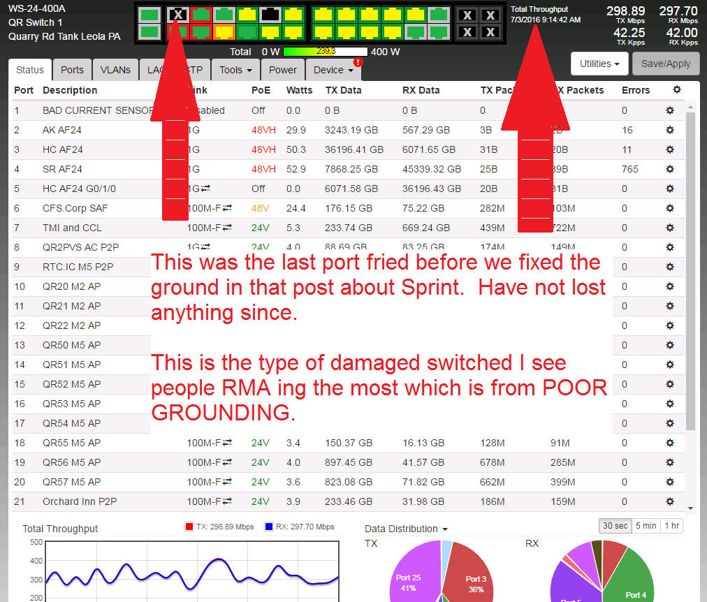

Answer to red text above: Because UBNT bonded the digital negative to earth ground in their radios (airMAX Rockets) which is why when you run a cable diagnostics on the 10/100 ubnt device you see short on pairs 3 and 4 instead of OK or OPEN. Also to achieve the ability to do a factory default with the POE brick they are tagged onto the power coming off the center tap of the Ethernet transformers on pairs 1 and 2 which is why if you try and power any 24V airMAX radio with 24VH it fries the switch port and radio as it can not deal with the power on pairs 1 and 2. They should have put in an isolated circuit in my opinion but they did not so there is no electrical isolation on their devices. So if you are using a Rocket then negative is bonded to the SMA connector which is bonded to the dish or sector which is bonded to the tower so any stray current on the antenna or around it on the tower will jump right on radio and follow your Ethernet cable down. READ THE POSTS I LINKED, it will tell you why low voltage high current not only kill equipment but causes Ethernet ERRORS like CRCs. And some of the information is from other companies and even people with PHDs in this shit.
No, the fact that the steel is a much larger volume does not mean that Static or ESD charge around your antennas will flow through the steel verses the Ethernet copper wire.
Look, there is a reason cell carriers spend so much money on grounding and I learned this lesson the hard way many years ago and more recently was reminded of this when Sprint left a tower and removed the copper wire on a "Steel" water tank which you can read the saga here on this post:
viewtopic.php?f=30&t=1429
When Sprint removed the dedicated ground wire I immediately started losing Ethernet ports and equipment on a tower that I have "never" lost any equipment on.
Basically here is the outcome of my loses when Sprint took out the dedicated ground wire:
In the fall / early winter of last year we lost Port 1 and 2 current sensors and port 1 Ethernet port of a WS-24-400A switch. We thought this was odd but there was a TERRIBLE storm that night and in fact lightening had struck a house about 1/4 mile in front of the radio attached to port 1 so we replaced the gear and chalked it up to bad luck.
A few weeks to a month or so latter the same thing occurred but the storm was mild and mostly rain and high winds. Once again we replaced the switch and thought this was odd but I asked my guys to service the ground. The way Sprint removed the ground cable that ran up the tower it was easy to miss as they cut the 1" copper wire 15 feet up from the main tower ground bus after it entered the cable tray and 15+ feet down from the main top ground bus.
We hurriedly installed a #2 green in that ran inside the water tank (Ball tank) and in the process added 2 ground buses and the #2 was spliced in the middle which adds insertion loss or resistance but again we lost another port 1 and radio. We next ran a home run non spliced #2 and since then have not lost another piece of equipment and we have made it through the spring and early summer lightening season.
The last switch that was damaged is still in service but port 1 is DEAD as seen in the picture below.
Look that is a Steel water tank that is welded together not bolted together steel pieced which would be an even worse ground path from all the connections.
Transient voltage/current will take the path of least resistance to ground and if you think your coated bolted together steel no matter how much mass will look more attractive than a 1 piece copper wire as a path to ground then you have already lost the battle and be prepared to lose gear on that tower every year.
I can tell a similar story to almost everyone of my 15 towers from before we learned proper grounding. I used to cringe and lose sleep on stormy nights but not including this tower I have not lost gear at any towers from storms in 5+/- years and that loss was a direct hit to a 150' water tank that blew the red light off the top of the tank and it landed in the parking lot. Then a year before that was a 175' tower we rent space on that blew off an AT&T sector and killed a 100 turkey buzzards that called the tower home. Before that you would go back several years when we first learning about proper grounding and before that we lost gear it seemed every other week in the Spring and Fall.
All I can do is try to convince people the importance to grounding. How important it is to have a dedicated ground path from any piece of equipment to ground that is shorted and less restive than taking the Ethernet cable. All pieces of equipment on the tower and in the box should be all bonded together and the path to ground from any radio to ground needs to be shorted and less resistant than the path to the switch/router and then to ground.
