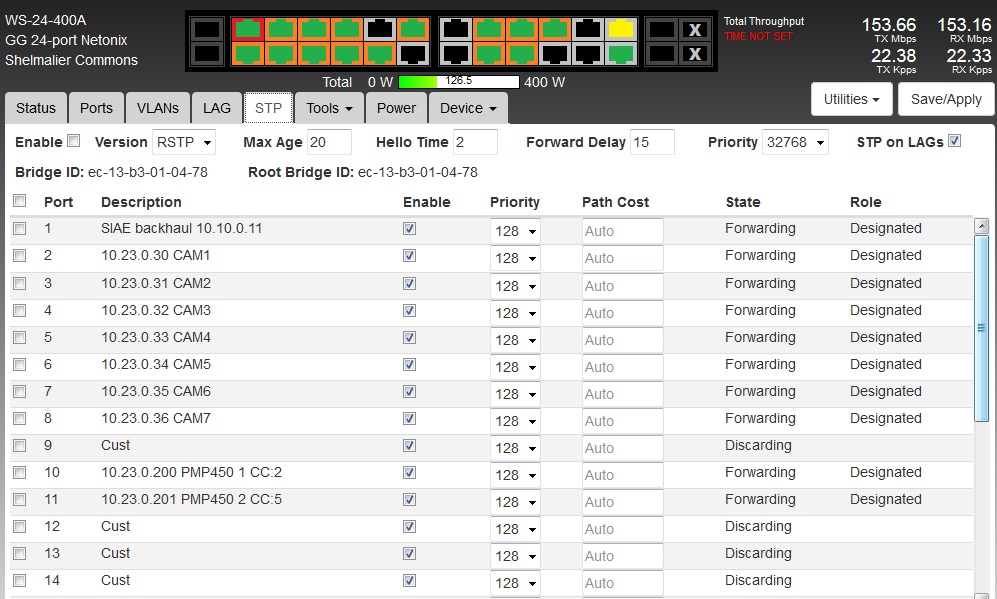

I've disabled STP and Discovery on the switch - as per this thread - but problem persists.

STP is not the cause so disabling this is not needed but it can not hurt to disable it for now.

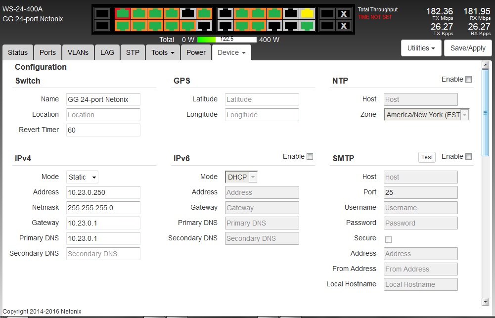

Disabling the Discovery Tab on the Device/Configuration Tab would be the suspected cause of the high CPU but you have to tell the switch to reboot after disabling it and let us know if the CPU utilization drops.
Could you tell the switch to reboot after disabling the Discovery Tab and report if your CPU drops to normal?

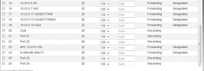

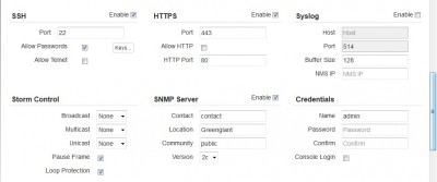

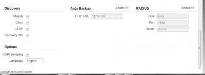

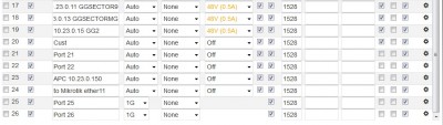

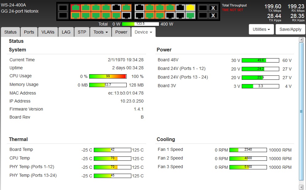

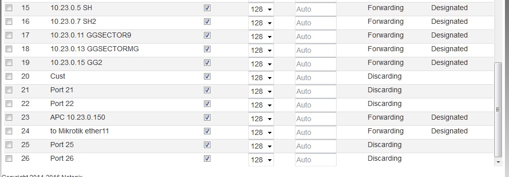

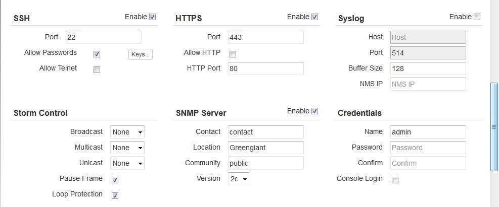

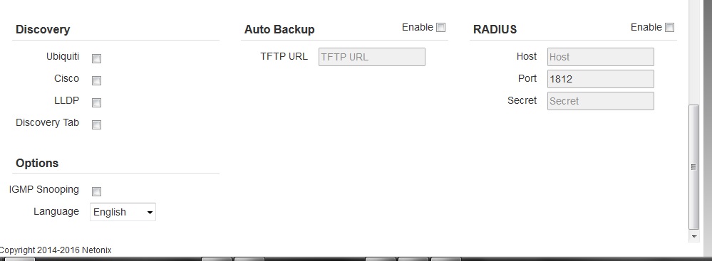

Re: v1.4.1 Bug Reports and Comments

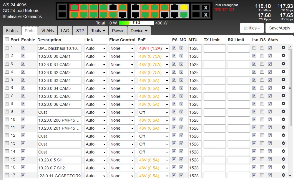

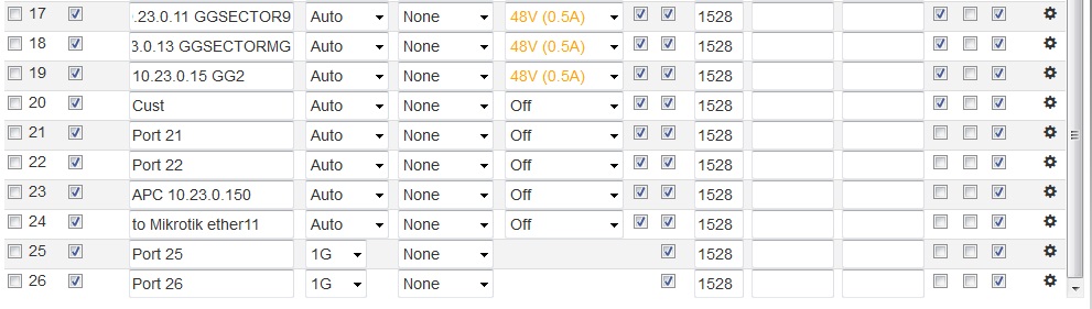

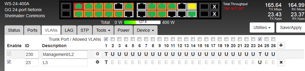

Config and Status tabs below.

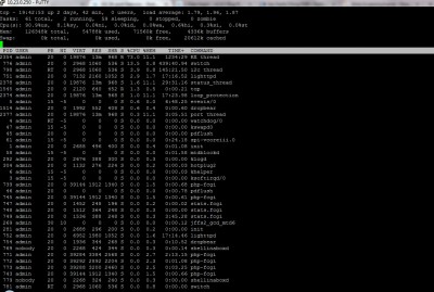

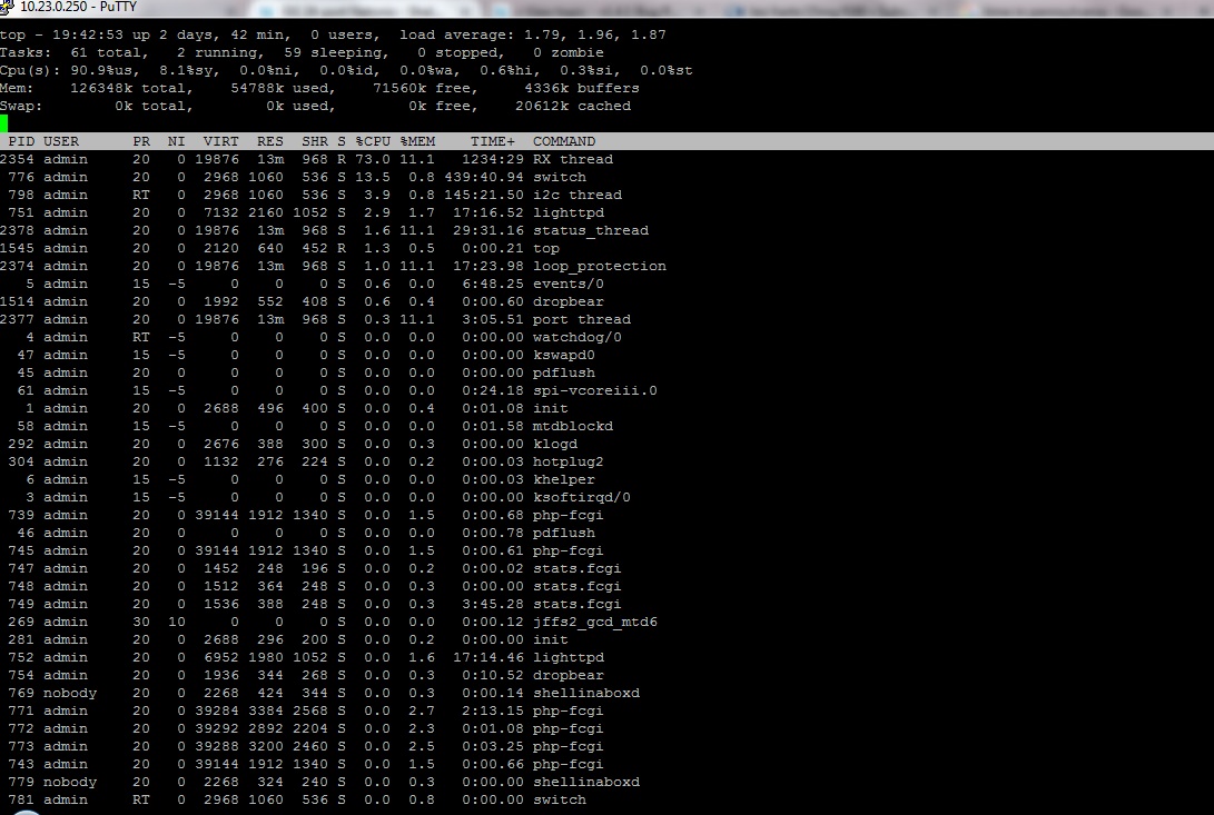

Here's the output of top - you can see RX Thread eating up a fair chunk of CPU time.
If you need any further info let me know.

After a reboot, CPU usage has returned to more normal levels, averaging around the 30% mark at the minute.
So it would seem Discovery tab is the issue?

I posted v1.4.2rc4 which now should properly allow you to enable and disable the Discovery Tab.
