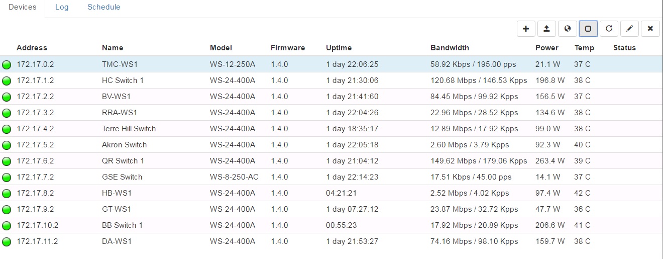

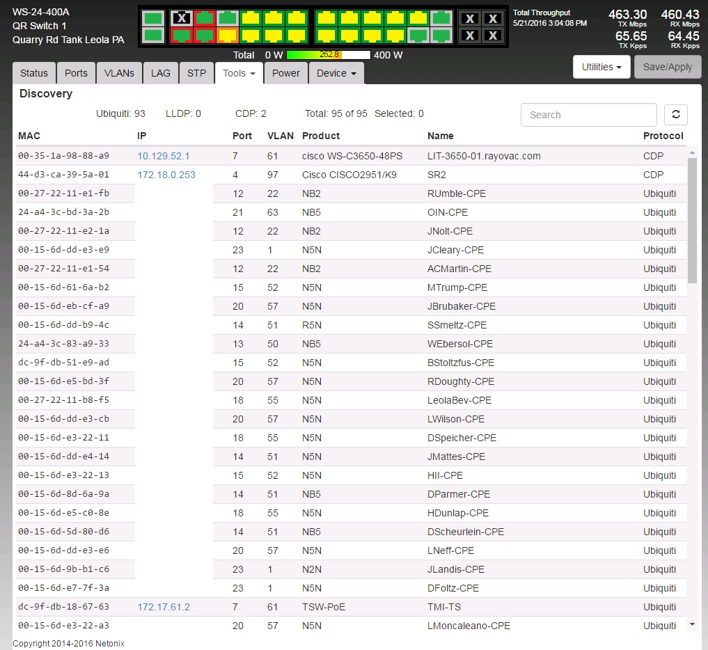

Well, what about some of the new features?
The Discovery Tab, I think this is a cool tool.
SMART DC models now have new graphs on the Device/Status Tab you guys asked for (up to 24 hours).

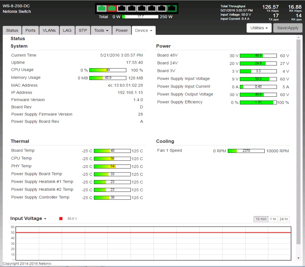

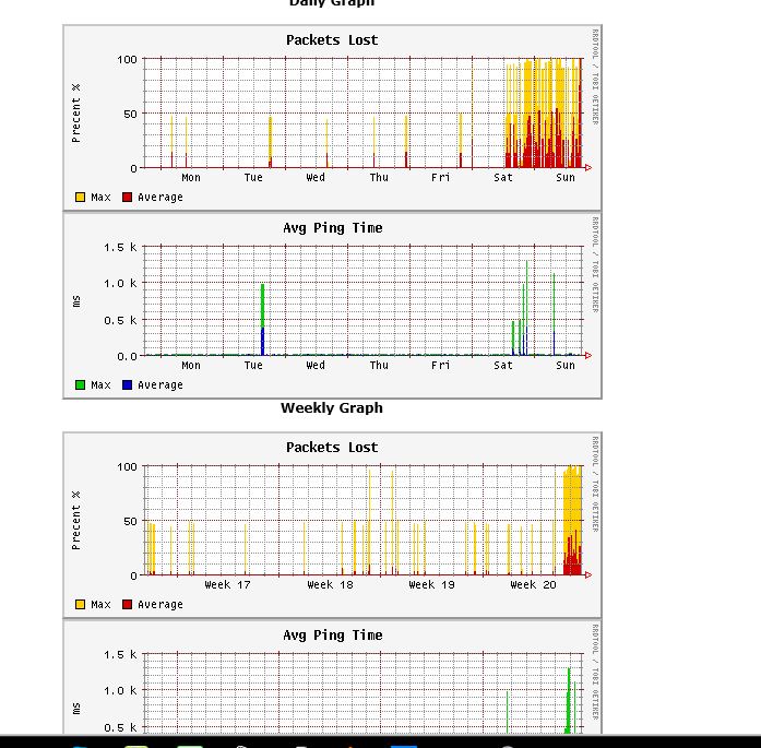

Sun May 22, 2016 7:12 pm
quite unstable since installing newest firmware two days ago,
Re: WS-250-12-AC
Sun May 22, 2016 7:27 pm
Considering that NOTHING has changed as far as switch core functions (the actual switching of packets) I have no idea.
I have it on all my switches at my WISP and they run GREAT?
I doubt your issues are with the firmware but feel free to downgrade if you like but personally I think v1.4.0 is our best firmware to date.
