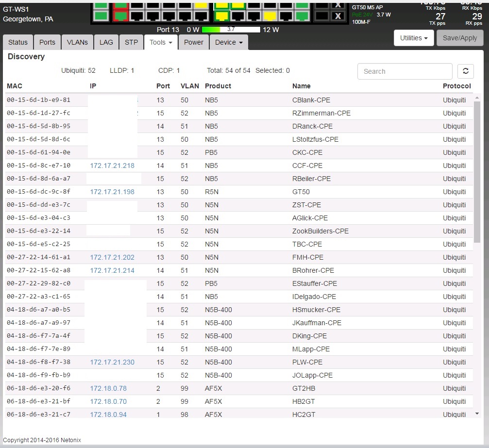

designweb wrote: I now have rc22 running on many various switches, ntp seems to take over an hour to update, whereas earlier versions time was correct as it came back up. Discovery used to show many devices Ubnt and Netonix on same vlan, now only seem to see netonix on lldp connected directly to its ports or via radio link.
The Discovery was just fixed in rc19 to actually be able to see all devices on all ports and VLANs. However it does not detect uniFi and airCAM stuff yet, next release.
If a device is set to be discovered via multiple protocols like the Netonix switch can respond on UDP, CDP, and LLDP if enabled to do so the switch will only report the FIRST one it sees. So if it see the Netonix Switch on LLDP first it will not show it on UDP or CDP.
We chose to do this to prevent the list from getting too large and showing the same devices on multiple discovery protocols.
Maybe we could say a device was discovered and on which protocols?
CLICK IMAGE TO VIEW FULL SIZE

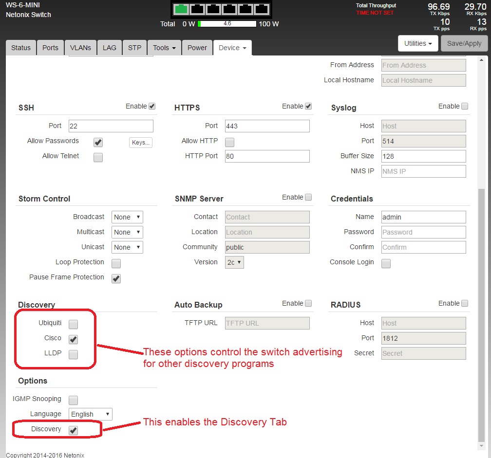

Re: v1.4.0rc19 - rc25 Bug Reports and Comments
Thu May 19, 2016 12:16 pm
WS-6-Mini
upgraded to 1.4.0rc25
I tried enabling Discovery (it was not enabled previously to the upgrade).
The Discovery tool just gives me this: "Enable discovery in the device configuration."
I tried selecting a single discovery method (UBNT) as well as rebooting the switch.
Thu May 19, 2016 1:41 pm
ryanm wrote:WS-6-Mini
The current version does not detect airCAMs and mFi but the next release will.
Thu May 19, 2016 4:57 pm
Well, I sure missed that one. Thanks!
