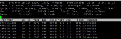

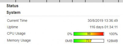

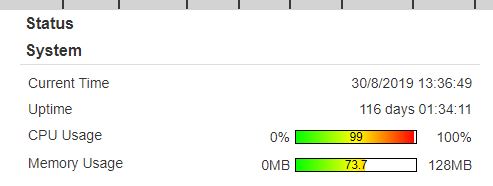

I'm following this post because i have the same problem. Sometime Netonix CPU is at 99%.
Ui made changes very slowly and by SSH need many seconds to show "login as:"
I have 32 Netonix Units and usually always there are 5 or 7 units with CPU at 99%. When rebooted the units or upgrade firmware CPU come back to normal state, but i think this is not a profesional solution...
I know wich Netonix are on 99% CPU because Netonix Manager show them on red point.
I attach some pictures for your help...
thx.
thx.

That is the firmware version for the switch. I was asking about the version of the Netonix Manager, we found out after this that the polling method of the Netonix Manager itself was causing switches CPU's to reach 99% because of extraneous process's being generated and un-managed. (you can read the release notes here)
If you're Manager is below version 1.0.14, then I highly recommend you upgrade it to the latest.
