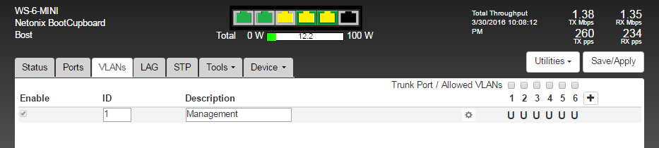

Can you post up a screen grab of your VLAN tab?
The only other thing I might suggest you try is to factory default the unit then manually set it back up (do not import config as config may be corrupt)

Wed Mar 30, 2016 5:10 pm
VLAN page

Well the only thing you can try yet is the factory default, if that fails you need to RMA it.
Do you have a spare switch to swap out then you can default and test this one on the bench.
