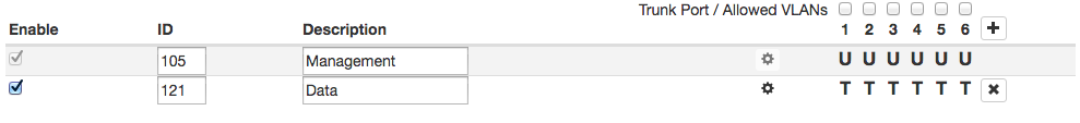

So here's what I gathered
IGMP snooping works as expected IF:
1. Managment vlan (105) untagged on all ports
2. Data vlan (121) tagged on all ports
3. Multicast traffic is on Managment VLAN

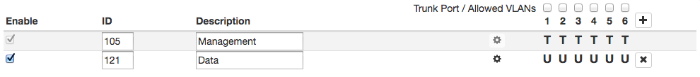

IGMP snopping does NOT work (multicast goes to all ports) IF:
1. Managment vlan (105) tagged on all ports
2. Data vlan (121) untagged on all ports
3. Multicast traffic is on Data VLAN
