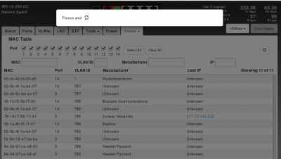

Access the MAC Table page works fine for the first time. But when I click the refreh icon or enter some VLAN ID as filter, the loading dialog appears for ever. I have to reload the complete page then. I'm using Firefox 44 here.

cegner wrote:Access the MAC Table page works fine for the first time. But when I click the refreh icon or enter some VLAN ID as filter, the loading dialog appears for ever. I have to reload the complete page then. I'm using Firefox 44 here.
Can you try Chrome and see if you have the same issues, maybe this is a BUG with FireFox????
I am not sure what you mean by loading dialog, please post a screen grab.

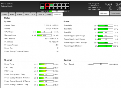

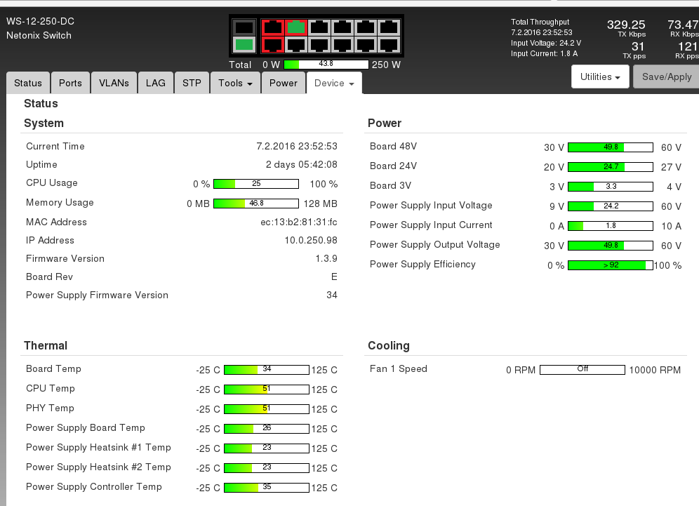

Also please post a screen grab of the Device/Status Tab
And you are sure this is v1.3.9 as there was a fix for MAC table display in v1.3.9

You're right, it seems to be a Firefox problem, Chrome works.
Firefox console shows the following error message:
- Code: Select all
TypeError: row.children[0].innerText is undefined
Yes, it's really 1.3.9 ;)

cegner wrote:You're right, it seems to be a Firefox problem, Chrome works.
This will be fixed in the next release.

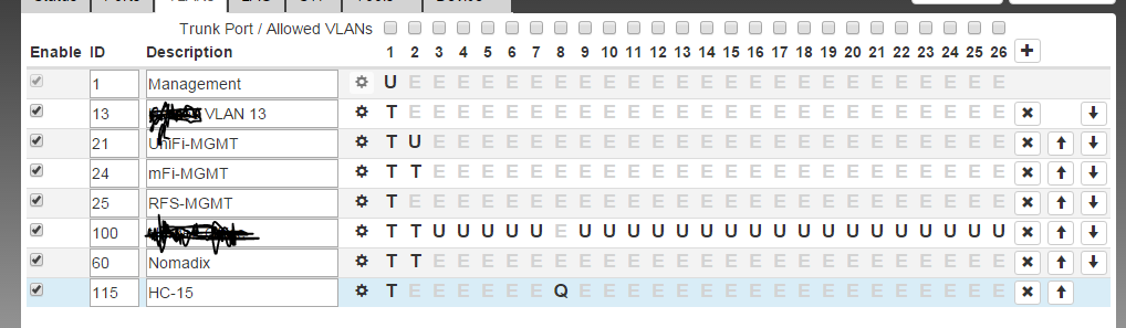

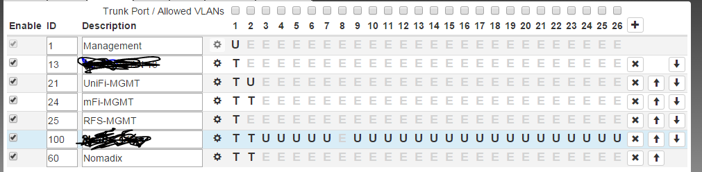

I too, am having this issue. When we try to go from a Tagged uplink port to some Q ports, we lose access to the switch, This past time that I tried it, the revert didn't take place, and I had to console in, remove the Q vlan and reboot the switch.
This is the working config:
When I apply this configuration, I lose access to the switch and it didn't revert:

The revert feature is working fine for other settings changes. I tested it with another VLAN change, it worked as expected. I hadn't changed the MTU setting before making the the QinQ change, but since I was having trouble pinging through a 32-byte ping, which wasn't part of the VLAN being QinQ tunneled, I don't think that that would be the issue. All traffic appears to stop switching. Perhaps, I'm not doing it correctly. I use QinQ tagging in our network a great deal, but I'm using the interface on the ring switch that feeds the wisp switch at the tower site. I'm trying to move the QinQ tagging to the WISP switch so that I can incorporate more flexibility. My ring switch is configured to pass the QinQ VLAN to the WISP switch as a tagged VLAN, along with the other VLANs, and this is the same setup that is used to send all of the VLANs into the Cisco router.
