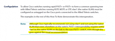

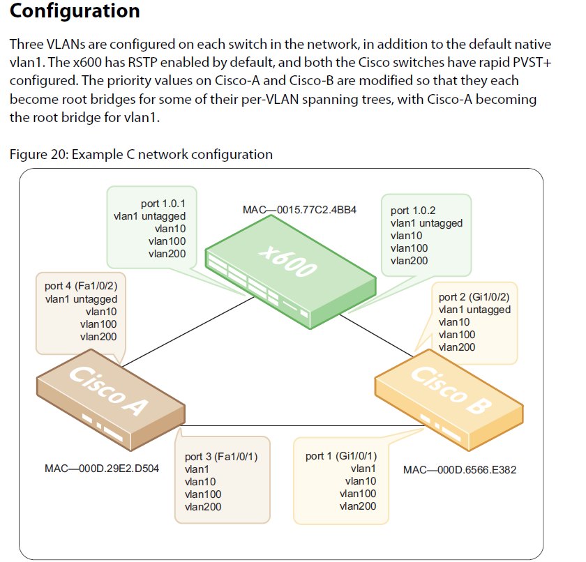

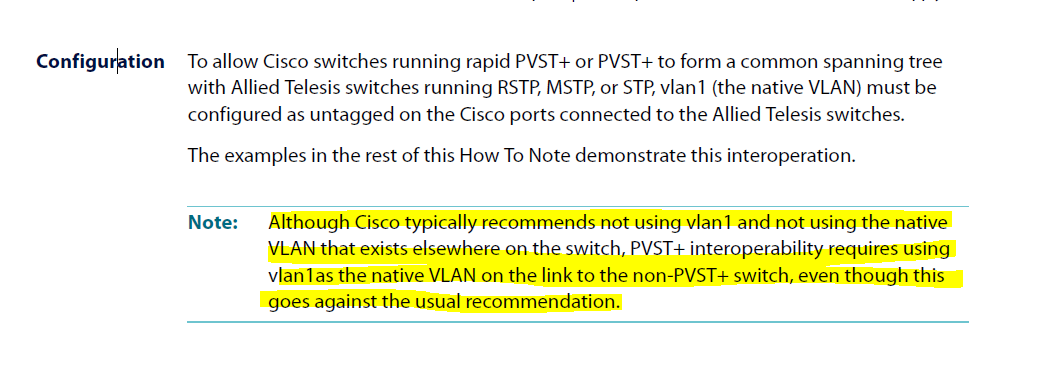

I am going to see tomorrow when I am scheduled to remove the Netonix to see if they are willing to give it a quick try. According to the document Eric found http://www.alliedtelesis.com/userfiles/ ... o_REVB.pdf It should not be necessary. They should just have to change the VLAN 1 settings on the Cisco. However, based on my phone conversation I am not sure they understood it that way or made the change.
See these excerpts from the above link.
